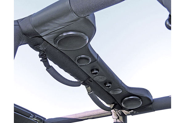

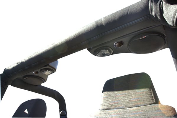

I've searched MUD and seen a variety of ideas for speakers. Many are speaker boxes mounted in the rear, behind the seats, or in the far back corners.
Others are marine grade can speakers mounted to the roll cage in various positions.
I like the idea of mounting on the cage. If I can find something that fits the 4+ cage, this could be a nice solution.
http://www.autoanything.com/jeep-tops/73A6007A0A0.aspx
Has anyone explored these options?

dont think those are stock speakers in the doors. certainly not a 78. the one speaker was mounted under the dash on the passenger side i believe.
my plan for audio when i get around to it is:
-wakeboard tower style speakers. easily removable. fits a range of OD roll bars depending on make. also all weather resistant
-if i can find a decent amp small enough, i will mount to the firewall up in the dash somewhere. with my emission computer gone, one could fit there. if not, on standoffs under the drivers seat.
-4th gen ipod shuffle (the one with touch screen and FM receiver) 5th gen ipod nano used on ebay, built in fm receiver. velcro'd to an alum bracket mounted in the stock radio hole.
maybe those ideas trip your trigger.

I like your thinking. I'm not so much a fan of those speakers, though it would absolutely work. And probably sound better too.
It occurred to me last week that my baby brother works in Denver selling car audio systems to dealerships, and he might be able to help out. It's not that I don't ever think about my brother, but I sometimes forget what he's doing for work. He's reliable and a good guy, it's just that has changed jobs often since....well, since he was born. I think some people have more of a wandering path through life that doesn't go high school, college, family, career, retirement...blast off.
I sent him the relevant specs for the cage and he's working up ideas. Cage is 49" between the bars, and the bars are 2" outside diameter.
Maybe something like these wedges would even work. I prefer something flush to the cage rather than hanging down.
