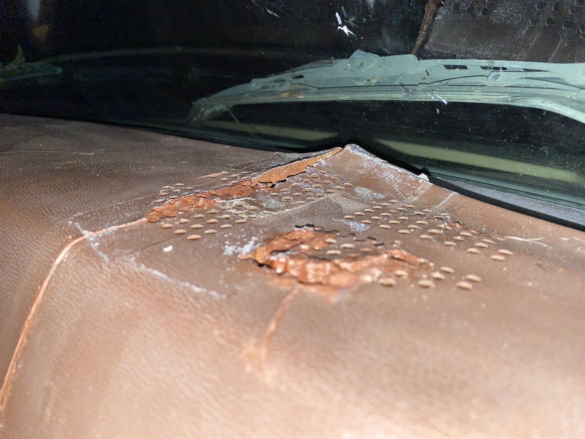

I haven't done it yet. My dash has geologic like features: canyons, anticlines, even what resembles a thrust plate. My tentative plan is to V cut the high spots along the fissures, might add some glue and a little silicone caulk to the voids. I intend to avoid sanding if at all possible. I think it will be done in place. I wiped it down with some 303 protectent and that's when I remembered that it only had one crack before I applied Armor All. A few months later it had several. Never using Armor All again.

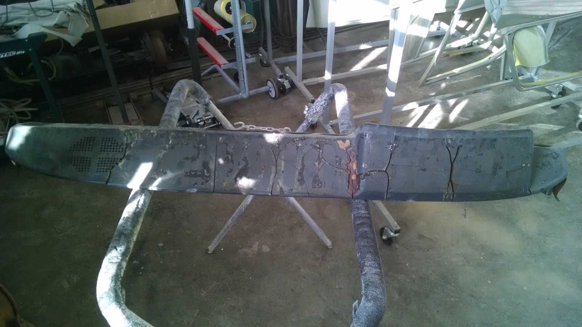

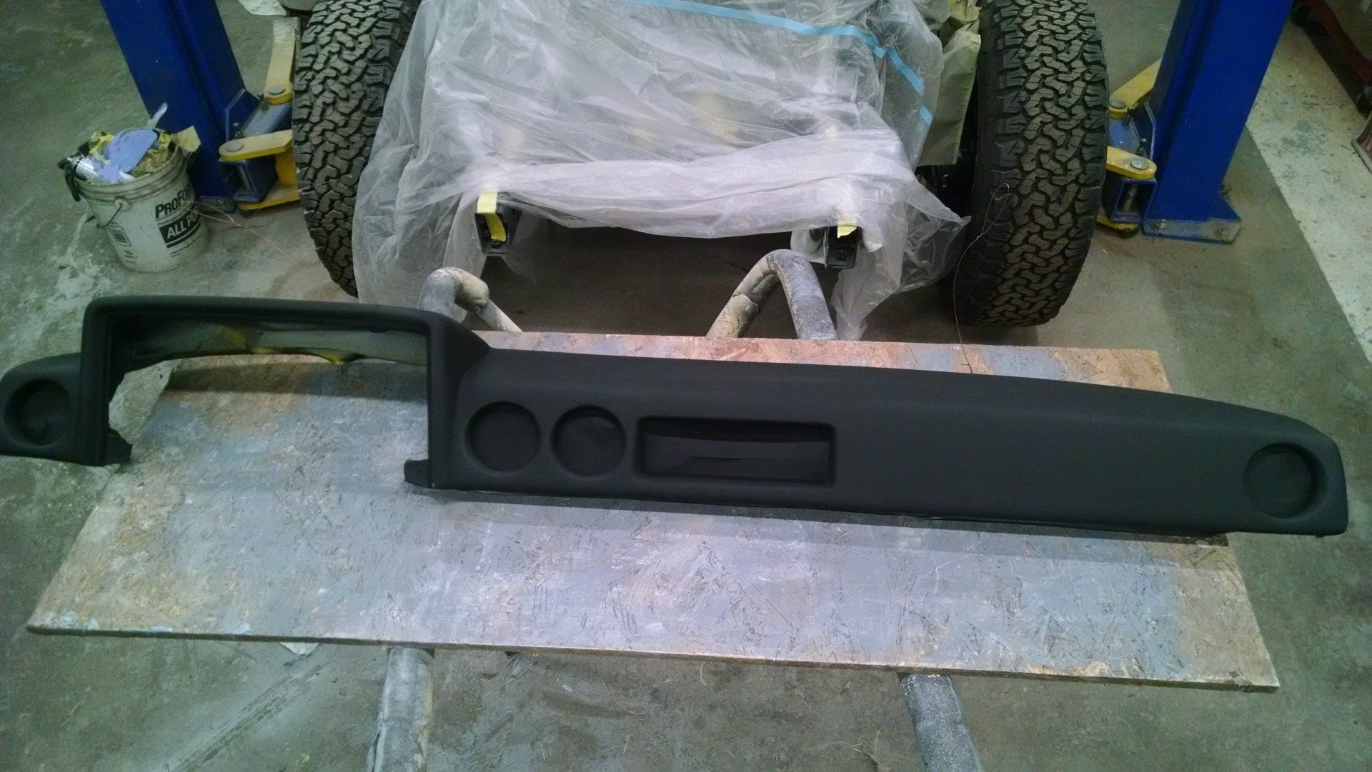

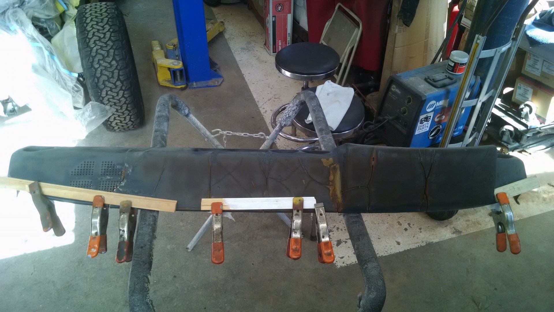

This was the worst dash I have seen to date. I cut out all the crap to the steel, filled with quality body filler, sanded it all out, glasses it all, sanded, sprayed with SEM texture and painted.
The original dash looks like a Halloween decoration. Jeez. Fantastic work! I wish I had the time/space/tools to do that. It is food for thought. How many hours would you say it took to do it?
FYI I got a quote from justdashes recently and they’re about $1,500 to restore the dash.
I'd have to go back and look at records to figure how much total time I have in it. A good bit for sure. I looked at JustDashes too. Something about paying someone else $1,500.00 that I know I can do myself just bugs me. Job in my shop, I do the work as much as possible. Down side is, if something goes wrong I know who to blame :)
It is really not that hard to do, just basic body work and fiberglass, shoot some SEM texture on it (practice on something first, something 3D and not just flat. Then paint your color of choice. I use SEM color as well. Don't glass in where the AC vents fit in. They are very tight. Good time to do something with the speaker holes on top and the single DIN radio slot if you have moved your radio.

@NCFJ that is awesome work! I am totally new to the car work but I did restore a fiberglass boat once. Can you give me some specifics on the type of filler used, fiberglass cloth, and any other detail that could be useful on the prep and process? Mine is beat to hell and could use a Hail Mary from me.
I used 3M lite automotive filler, available at most places that sell body repair supplies and paint. Regular weave fiberglass cloth. I use west Systems epoxy with great results. Just remove any loose material from the dash first and epoxy down the edges where required before using any filler. Remove all dust and wipe down with a grease and wax remover before using the filler then again before the glass.
