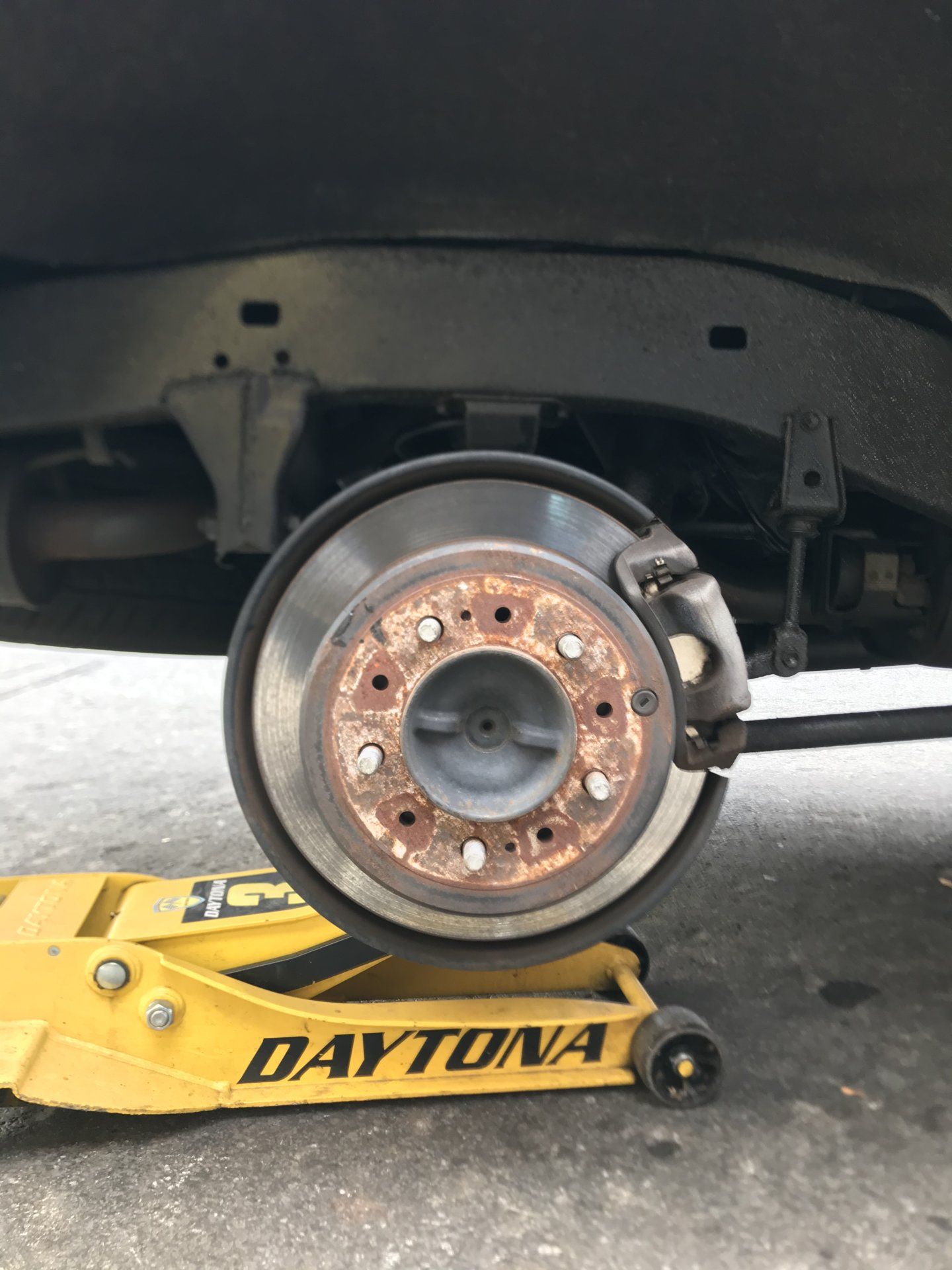

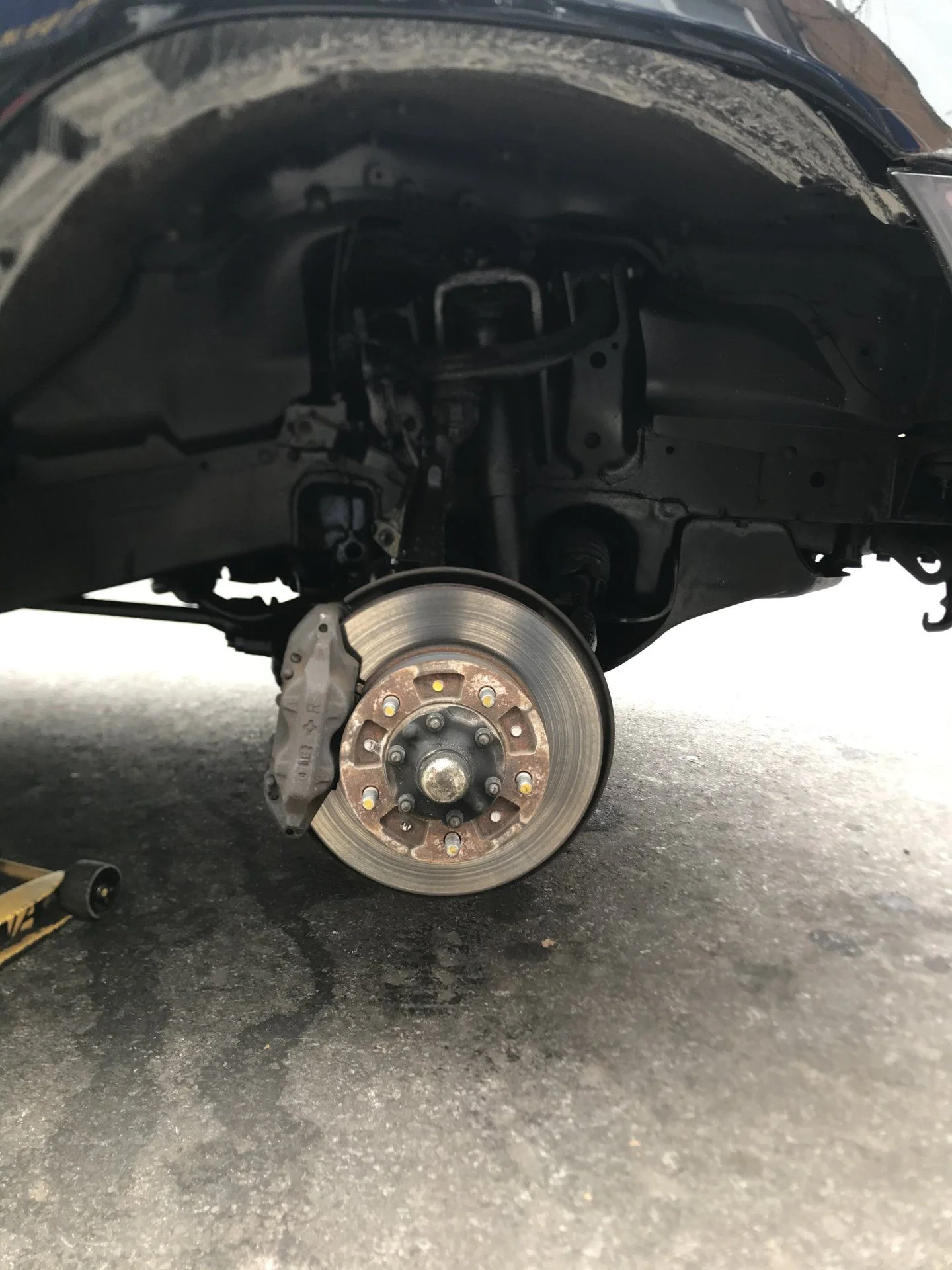

Hey everyone,
I’ve been trying to find info on which brake kit to install on my 2006 LX470. They seem a bit rusty and old so I’d like to add some new life to them. I was thinking of upgrading to drilled and slotted rotors with new calipers and ceramic brakepads. What brand do you guys recommend. I plan on doing the installation myself and it will be one of my first projects that I work on my car. Actually I’ve never done any work on any car so I will need a step-by-step step process eventually. But I am confident I can pull it off. Anyway, what do you recommend? Are there any OEM parts I should look for? Current situation below:
Thanks
Larry
Calipers don’t look bad. Consider rebuilding them if they’re OEM. Rebuild kits are dirt cheap and just require time and an air compressor or bike pump...
For rotors and pads, I suspect you’ll get a ton of different answers. Nothing wrong with OEM for either, IMO. I also like powerstop. Also, that rust you see can be sanded off...
If you’re doing this work, would be a good time to also replace the soft brake hoses, repack wheel bearings, etc.
Are you experiencing any braking issues now or just want to "upgrade"? If the current stuff is within spec/thickness and stops the truck, spend the money elsewhere.
I was a bit concerned with the rust in between the rotor. Seems like it has life left in it but I just wanted to eliminate any sources of rust. What is the best course of action? I was looking forward to the upgrade but wouldn't mind waiting.

The rust you’re seeing in the pics is mostly the wheel hubs, not the rotors.
Rotors are typically made from cast iron and will rust just from existing. Purely cosmetic and nothing to be concerned about, especially in the vents, visible from the sides.
