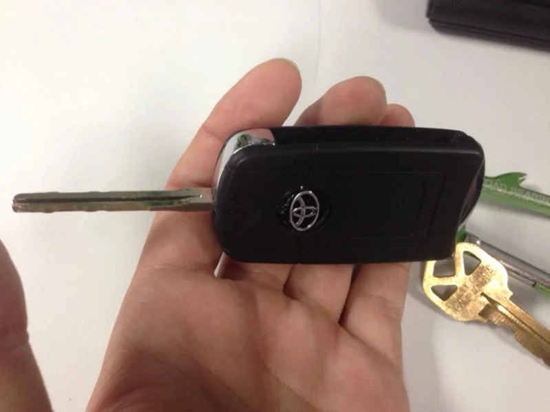

That's what I'm saying, everyone needs to know about this IMO. I'll post some pics up in a second, but ya it's everything that you'd expect, for $14. It's really solid feeling in my hand, and when turning in a cylinder. The only thing that should be noted, is that you have to twist the two shells a couple turns to get the spring loaded action to work right on reassembly. Replacing the battery when you assemble it will save you from doing it when a used battery wears out sooner than a new one.
EDIT: Here's some pics:
Worlds largest car key? OR exceptionally small hands?
