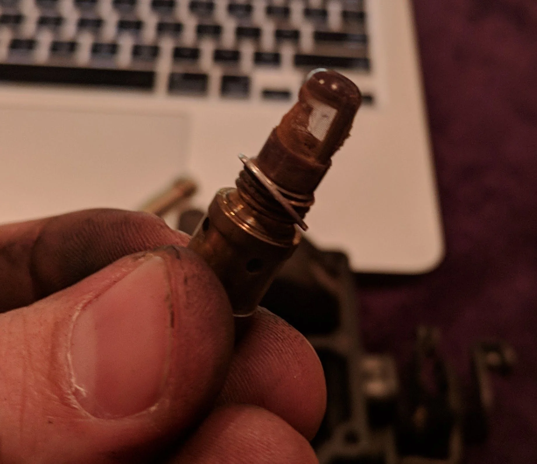

I'm starting the process of rebuilding my stock Aisan carb and the little filter/screen at the fuel inlet is toast. Are these available anywhere? or is there a suitable alternative?
This is a big reason I stopped running the stock as it was constantly getting plugged when little bits of crud would make there way in and clog everything.
Plan B: add a fuel filter right before the carb
It does, and it is clean. from what I can tell, the metal fuel line between the pump and the carb has some flaking on the inside. Or remnants of crap from before I cleaned the fuel system that have settled into the new fuel pump that occasionally work their way up and out. So the first filter doesn't stop the problem.
I ran the stock carb without that screen for a couple months, and it was a time bomb for getting clogged and left me limping down the road or completely stranded.
The troll hole I run now has the screen intact and is yet to have the same clogging issue
