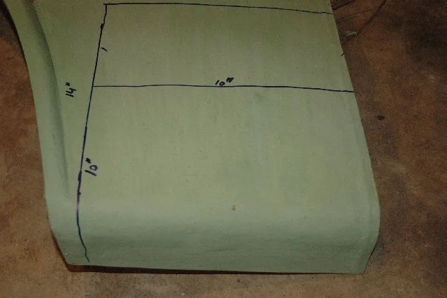

You mean just the portion that you have highlighted in the last picture? You need that?
Ehsan
Hi Eshan,
Yes, the highlighted portion. And I am not alone, many FJ55 owners will need these and they are hard to fabricate...
Best Regards,
George
Hi Eshan,
This is a good question. I think this specific panel should be made generic, and should run almost all the way to the rear wheel well.
Each owner could then trim to fit as needed.
Many FJ55's have rust-through from the wheel well all the way down to the corner.
I would like to know what other members think?

This is very makable. However, I need a pattern to work on. I am looking for one here in Pakistan. If any of you could just make a single sided mold out of Plater of paris and send that in, it would do the job. I need just the rear corner to get the perfect shape in repro panels. Anyone?

Hi Eshan,
Those look great! Email sent.
George
Email sent; I am in whether front or rear..still not clear where they go w/o a view of the entire fender<LOL>..........would like to see the entire fender to orient myself!..........like the story of two kids drawing a trunk with glasses...one drew a steamer trunk with a glass on it the other an elephants head with glasses and a trunk!
Lou
Lou-
Orient youself with regard to that raised lip. This is for the lower part of the front fender, where you would bolt a mudflap (sacrilege!) onto.
Seen another way (the other kid who makes the elephant), looking at the front wheel well, this is at the rear of the well. The raised lip diminishes to zero as we reach the lowest point of the well.
