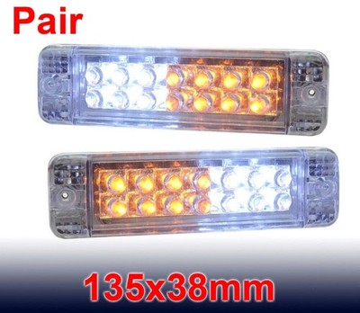

I found these:
Combination LED DRL and turn signals. Direct fit to an 80 Series ARB bar. At the current exchange rate, about $40 for the pair.
The turn signal wire is tapped into the OEM turn signal and the DRL is run off ACC power with a separate dash switch. They come in handy to throw some light into a camping spot while setting up at night, and I don't have to have the truck "ON". They use very little current and make very good DRLs.
