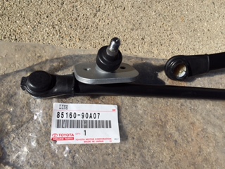

The weak link in our wiper system is the rods off the motor. They use plastic cups. At the age of our trucks too much friction my cause these to fail. I have spent literally hours working on my wipers. These cups are not available from what I could find. I had to get junker ones.
You don't want too much strain on these rods. You may even find with old wiper motors they won't move quick enough back and forth due to the extra tension on the glass.

The linkage is still available.

Has anyone come up with a fix for the parts that are NLA? Did you do anything other than replacing the parts with used parts?
That's good to see you can get these. I used old ones. They are a tough think to work on. They break easily, don't only buy two or three. Get 6 of them for spares!
When I went looking for the bushings the only thing available was an assembly, which had the rods and bushings etc. It was well over a 1000 dollars. I'd be putting in an electric hot rod version before I wasted 1000 bucks like that.LOL
I agree I would not pay that much. But the whole assembly is available for $226 US dollars.
Is that at a toyota dealer still in stock? New stock?
The wipers may be frustrating, but thank goodness they are not pneumatic wipers or something awful like that.
I installed this last year. Cost was worth it rather dealing with the bushings,which I did not know were available.

Hey Tapage, that linkage went on my 62.I got it from Beno and I think it should fit the 60 as well but not sure. It came with the round rubber boots also. I bought new arms,wipers and plastic covers that go over the mounting nuts.
