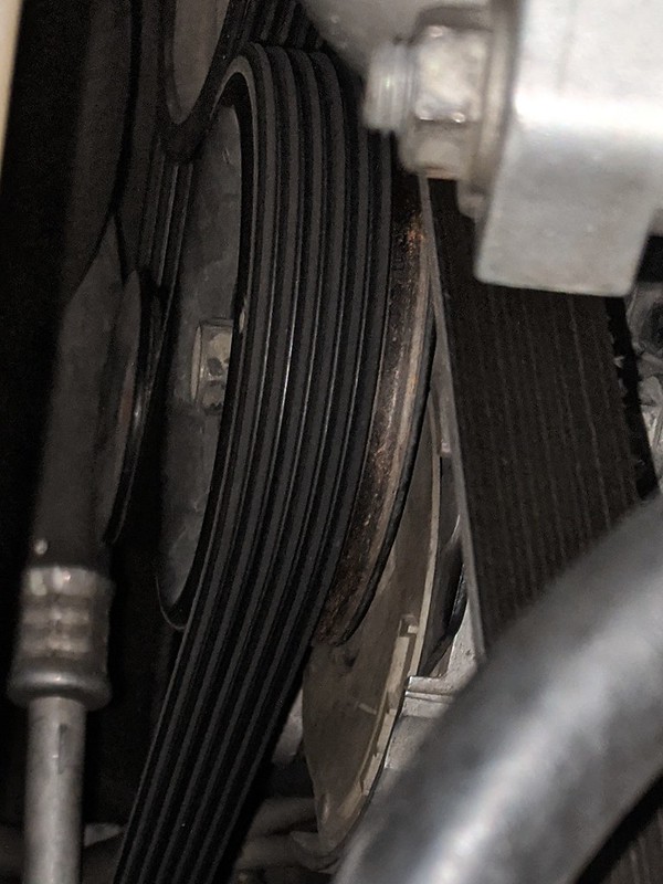

hi all... instead of starting a new thread, figured i'd piggy back on this one.
can you guys check these pics of my serpentine belt and tensioner? i feel like the belt isn't aligned right... would you all recommend replacing?
also, what parts would you go with? oem?
