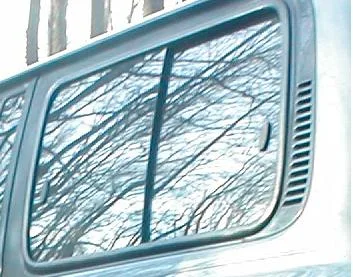

I am talking about the window behind the small triangle one. It slides in the window frame. There are two of them together.

Its not too difficult to get the window/frame out. Just takes a little patience and some pushing and prying of the rubber gasket. Here are some pics when I took mine out to seal a leak in the jack area (the quarter panel had been replaced at one time and the seam had a leak it in. I think it can be removed without taking off the rear vent moulding and lower window trim on the outside. On the inside though, I think you'll probably want to pull out the lower plastic panel.
I didn't take it apart any further, but I think that center support unscrews and then you spread the frame some to pull out the glass.

Can you remove the glass or the slider gasket without removing the entire frame from the truck? Also, where do the drain slots in the bottom of the window frame drain to?
Well, this ain't gonna help you, but I was playing catch with my daughter and she overthrew me by about 5 feet and broke one of the rear sliding windows (only broke one pane, the other was fine).
Here in Los Angeles, there's an area on Alameda Street where there are tons of repair shops that specialize in "one" area such as radiators, windows, mufflers, transmissions, etc.
I found one place and they wanted $250 to fix it, but the guy didn't have the sliding window and he needed a couple of days to get it. I drove to another place about 1/2 block away. The guy goes to the back of the shop and comes back with rear sliding window/frame.
He showed it to me and I looked for the Toyota stamps on the glass. I asked him how much and he said $100 cash installed and out the door. It took his guys 20 minutes to clean up the broken glass, pop out the broken window/frame, and install the "new-to-me" window w/frame.
I was a little shocked that they didn't remove any panels and they only tools they used were a screw driver to help pop it out, and soapy water and a rope around the window/frame to snap it into place. After 1 year, no problems with air or water leaks.
Window w/frame means both sliding windows plus the metal frame and gasket. I kept the broken window/frame as a souvenier. I wish I had taken a video.

hi guys about to replace the two piece rear quarter glass panels with a one piece but im having trouble fitting it into the aluminium frame. is there something im missing ? would i have to snap open the aluminium window frame at its joint to fit the panel and then weld it closed again ?
any help would be appreicated
Ok managed to do it and here it is. It was a nightmare to fit into the aluminum frame. So had to desperate the frame at the joint.
So happy with the outcome
Per the parts diagram there is no aluminum frame for the factory solid window...I can confirm this as I removed mine in favour of an access hatch.
Should just be the glass and a seal.
