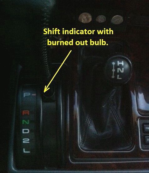

I am wanting to replace the bulb that back lights the transmission shift position (Floor Shifter) right in front of the center console.
Can anyone tell me how to access it? Perhaps remove the entire cover there...or is it simpler than that?

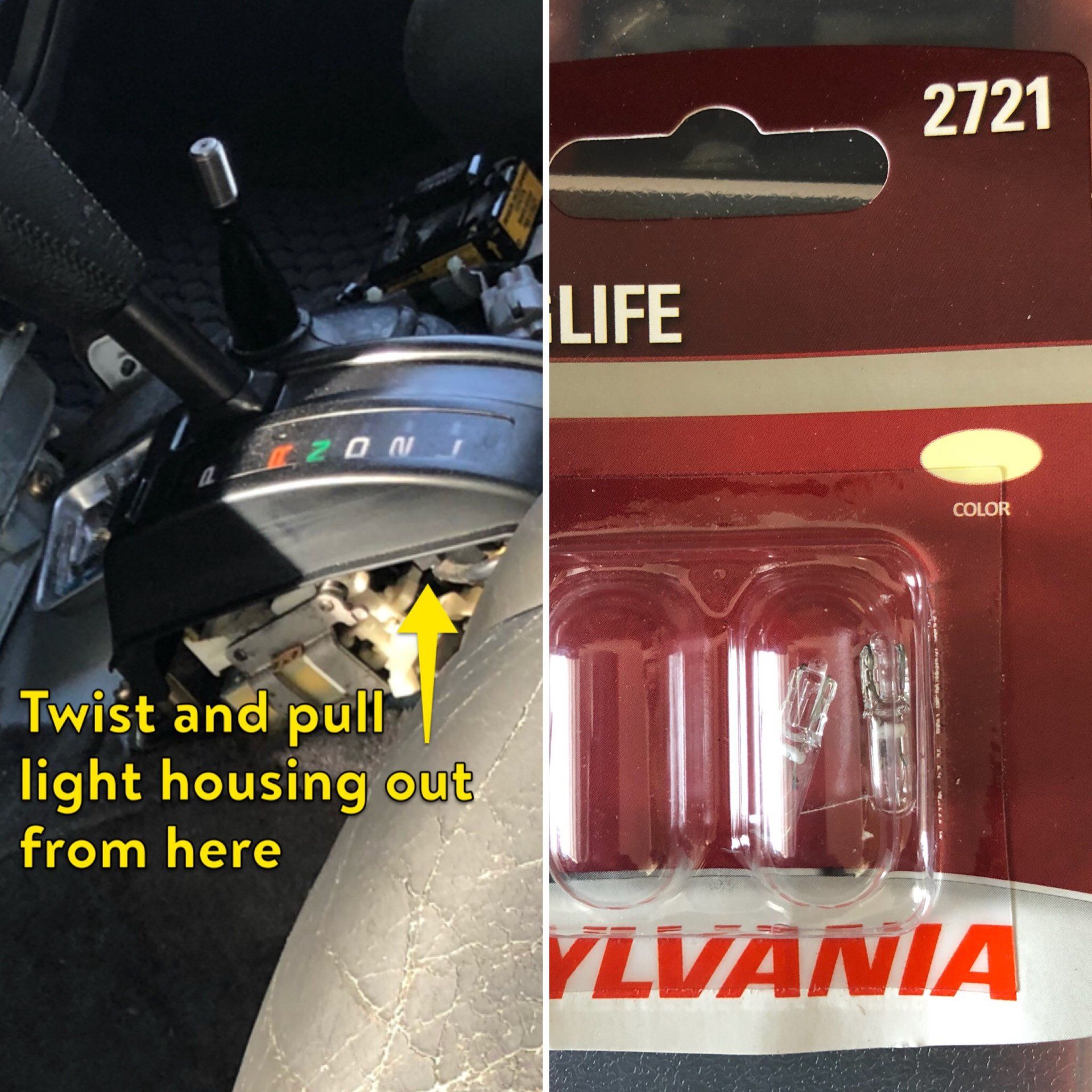

Yep, pull the cover. Once its off, its pretty clear where you have to twist the lamp socket to get to replace it. That is the only way I know to get to that bulb

Here’s a visual aid along with the bulb number you can get from any auto parts store. This bulb also fits your glove box light and ashtray light, if those are important to you.
^^^^^^^^^^ Excellent! Thank You. I am going to replace mine with an LED..but good to have the bulb number.

Update: Done.
Easy Peazy.
Move transmission shifter to neutral position (be sure your parking brake is on or chock the wheels). Move T-case shifter to 'low' position, then remove its shifter knob. These positions will best allow you to raise the shifter cover enough to access the bulb.
There are four screws holding the cover in place. (Two) on each side at the front most portion toward the firewall and (two) at the rearmost portion close to the center console. The rearward mounted screws are best reached by moving the driver and passenger seats all the way back.
Then carefully lift the cover up and rearward. The leather T-case shifter boot will slip over and off the shifter. The shifter cover will hang up on the transmission shifter handle but will be high enough to expose the light bulb receptacle. See post #7 above.
To remove the receptacle (facing the shifter from the drivers side door) turn/twist it Clockwise 90° and then simply pull straight down. The bulb is a type/number 74 bulb (wedge). The factory bulb appears to be a white bulb with a green cover on it.
I first thought I'd replace it with a white LED, but decided that would be too bright, so I stayed with a green LED.
It is a simple 10 minute job (if you don't stop to clean out all the small stuff that collects on and under the cover).

The color of the LED will show up through the positions (P,D,2,L).
The position for reverse (at the shift indicator is colored red, so will appear extra red, the neutral position is colored green, so will be darker when the red hits it.
The other positions on the shifter (P,D,2,L) since they are white... will show up as any color bulb/LED you choose to put in there.
Look at the photo (non-lit) in my post #12 above and you will see what I mean.
