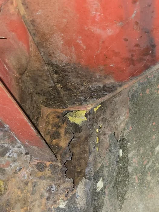

Looks like this. Involves the body mount area. Repair or replace whole cowl. The vent panels are also rusted
And unfortunately, the extent of the rust will probably be worse than what you can see now. That’s the issue with Toyota sandwiching multiple sheets of metal together

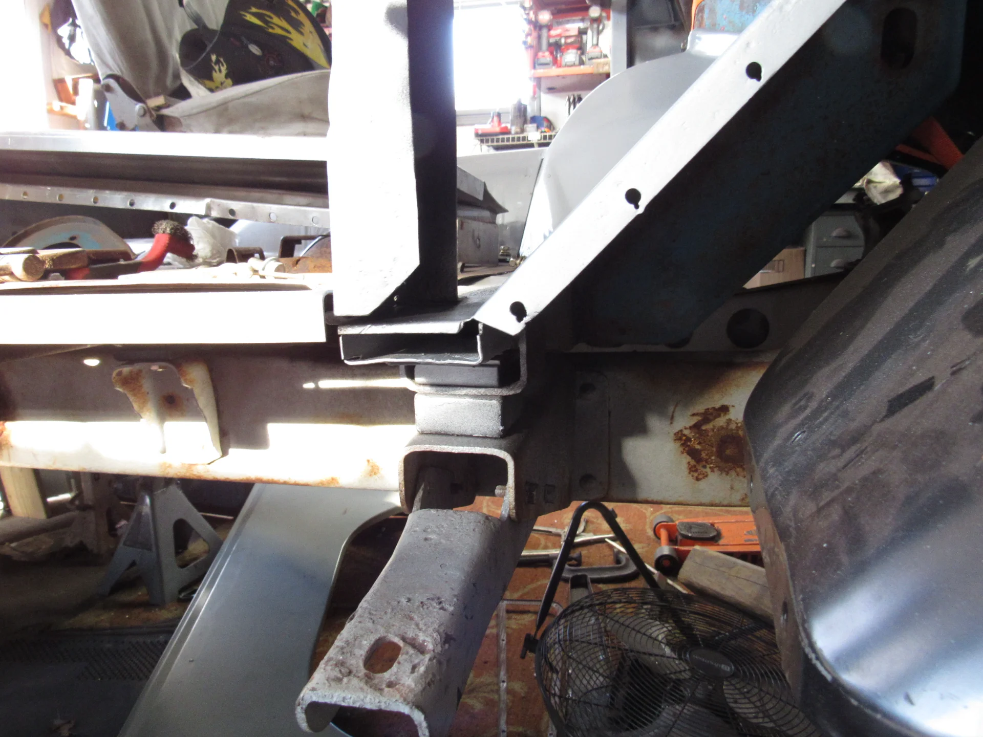

Both sides of my floors were like that. Ended up replacing inner/outer rockers, floor and toe boards. Not to mention the rear quarters, sill and wheel well tops. Probably would have made more sense to just get a new tub.
