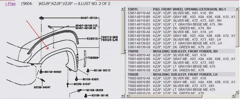

our plastic fenders (gray or silver)have several small bases that keep them in touch with the metal fenders..
these were broken and the price was 450 euro (in greece)
so i use sikaflex 291 to repair ...
