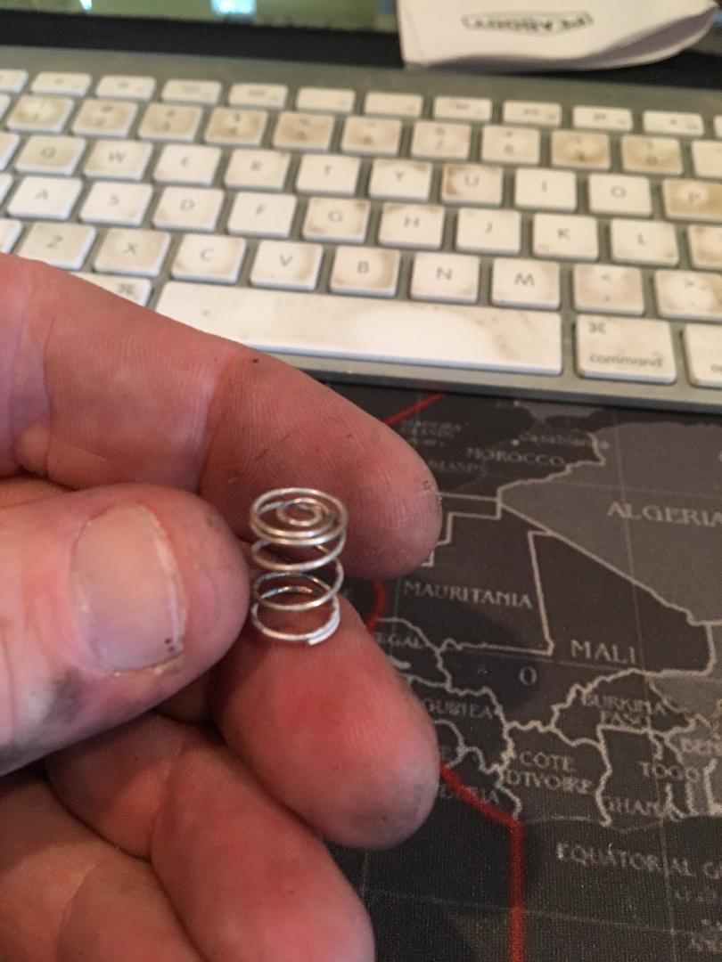

so I got it off by going back and forth...wondering about putting it back now. Trying to figure out where a spring that I found on my floorboard came from before I put the wheel back on. Any ideas?
Do I just push it on as far as I can and then let the nut do the rest as I tighten it? also, I dont have a torque wrench....I suppose it is time to get one.
View attachment 1765219 Do I just push it on as far as I can and then let the nut do the rest as I tighten it? also, I dont have a torque wrench....I suppose it is time to get one.
If you are going to work on your Cruiser, a torque wrench is a must. Get a 3/8 drive and if you can afford it, digital is nice:cheers:.
