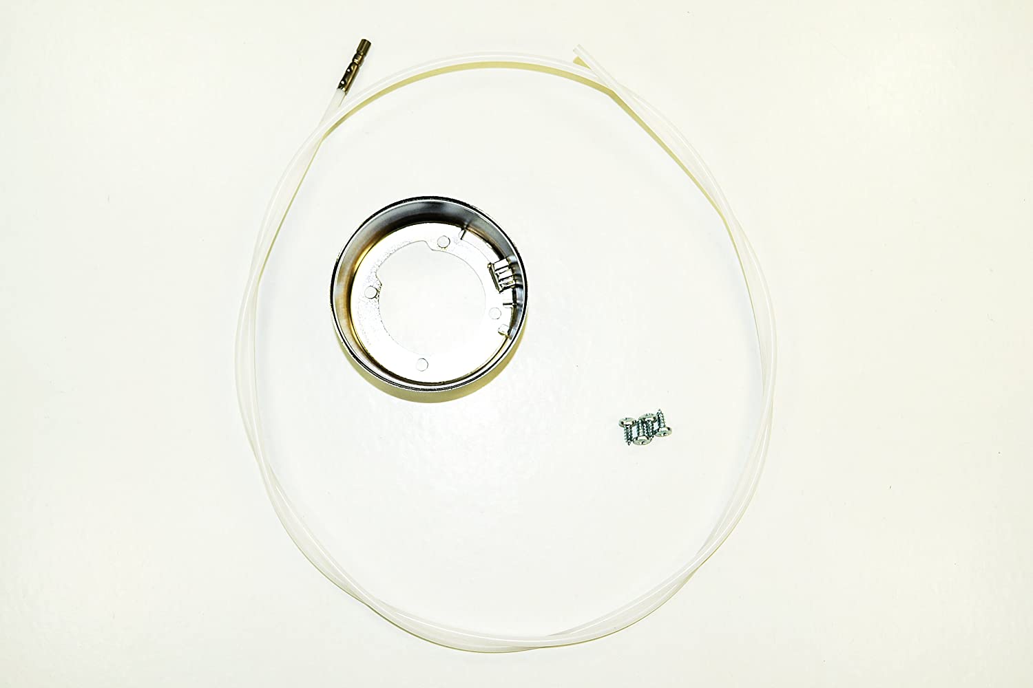

I was doing a search on line tonight and came across this power antenna repair kit that covers most of our trucks. So if you're metal antenna mast is not broken, and all you need to replace is the nylon cable along with the metal drum i found this kit on amazon for 56 bucks with FREE shipping, below is a link.
Amazon product ASIN B00JU9EB3E
AntennaMastsRus - Power Antenna Cable and Drum is Compatible with Toyota Supra (1985-1992) - Toyota Camry (10-1988-1991) - Toyota Celica (1986-1989) - Toyota Land Cruiser (1990-08-1996) - A121
