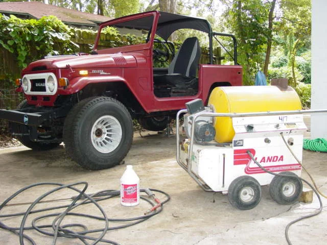

LANDA- 300* hot h20 pressure washer
Available at most tool rental places.
This is the magic wand you are looking for.....
http://www.landa.com/showProductSeries.aspx?series=17&type=1
Most rental places are closed on SUN.
Reserve one on a SAT and return it MON.
I was only charged for 1 days rent and had the machine for almost 2 days.
Rent and fuel came out to $100. Find a buddy and split the costs/ use of machine.
Blast steam thru the frame until all the water coming from the holes is clear.
Regular pwashers won't cut it......... the h20 must be steaming hot.
The hot water also washes off grease like butter.
