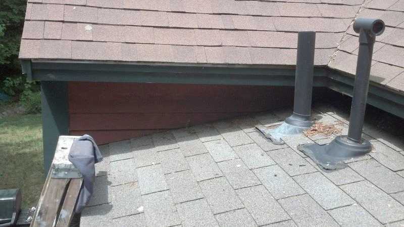

I need some input from the group on the best way to remove some beveled cedar siding on my house. I need to re-do the roof on a tool shed that was put on by the PO, but they obviously didn't know what they were doing. It's only 5' x 10', between the main house and the garage, very flat (2.5/12 pitch). No step flashing, no ice & water shield, so now it leaks at both ends.
The vent pipes are for the radon air & water systems, and ya stupid place to put them right under the valley, of course they leak now too. They will be moved, since I need to replace the sheathing too. :bang:
Cedar siding is ridiculously expensive, so I'd like to save & reuse the pieces that are on there now. Any suggestions how to get it off without destroying it? I have lots of pry bars, a sawzall, and an oscillating multi-tool at my disposal. Nails are stainless ring shank, very tough, difficult to remove. My experience has been that trying to pry them out from below the siding usually just tears the nail head thru the siding.
Should I just use a pin punch to drive the nails thru the siding, then caulk & stain when I re-install? Appearance isn't that important, this is the back of the house, and those spots are kinda hidden.

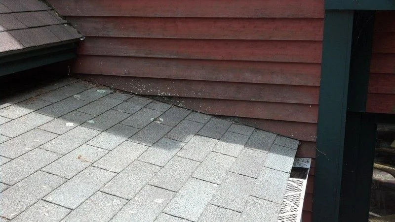

Yeah I would just pull the cedar off carefully, leaving the nails, just get a good flatbar work your way behind them and work them off, if the wood splits, and it will, keep the bits and glue back together using weatherproof wood glue, Titebond type III, and blue tape to hold it together while it cures. The siding looks like it goes down to far, you should have a space between roof and siding at least a 1/4" , I would go 1/2". This prevents water from wicking back up the siding. While your there put some flashing behind siding and if you can, under shingles. But you know that.
Vents can be a bitch to move, they shouldn't leak, even if someone put them directly under the valley drain off, I would think reflashing them correctly and maybe some sort of gutter/flashing to redirect water away from pouring onto vents will be easier then rerouting vents.
Good Luck.
Yeah, that's another mistake they made, the siding is right down tight to the roof, this is wicking moisture up the sheathing and causing the leaks. Not good for the siding either, so it will be trimmed.
The shed is open under that roof, lots of access, it will be easy to move the vents. The radon fan is right under the roof. The contractor that put them there was adamant about the location, something about a code that they needed to be 5' away from any other windows. I knew they were gonna leak, told him so, and I was right.
I have a new box of Grace Ice & Water shield, I'll run it at least 8-10" up the sheathing from the roof, then step flash the shingles (with sealant). I hate leaks!

in your case you might consider just running a skilsaw along the siding parallel to the roof line to remove a couple of inches of the siding ( cut away the last bit under the eaves with a backsaw or dovetail saw ). you should have that much spacing anyway and it will be easy to slip the new flashing under the cedar.
Winner.
Lay a board on the roof to guide your circ. saw and finish the ends with a hand saw, or sharp Olfa knife. You will probably have to punch a few nails through to get your flashing up under the siding though.

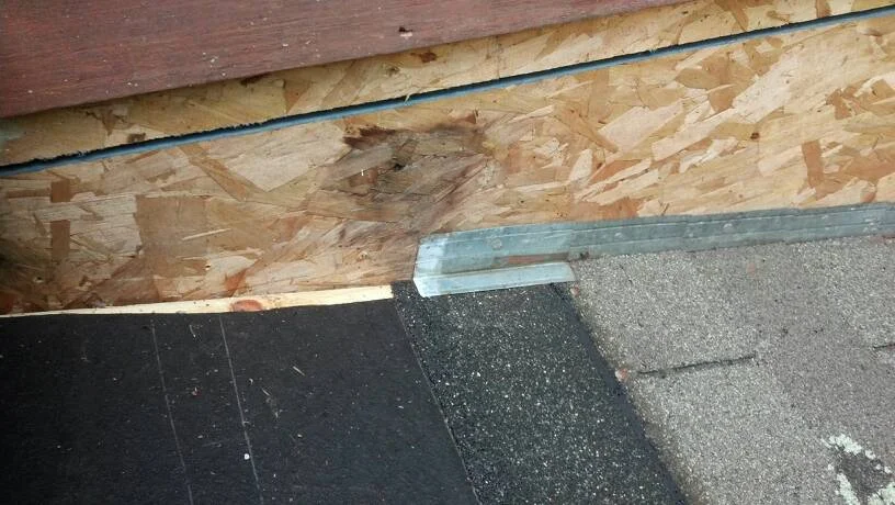

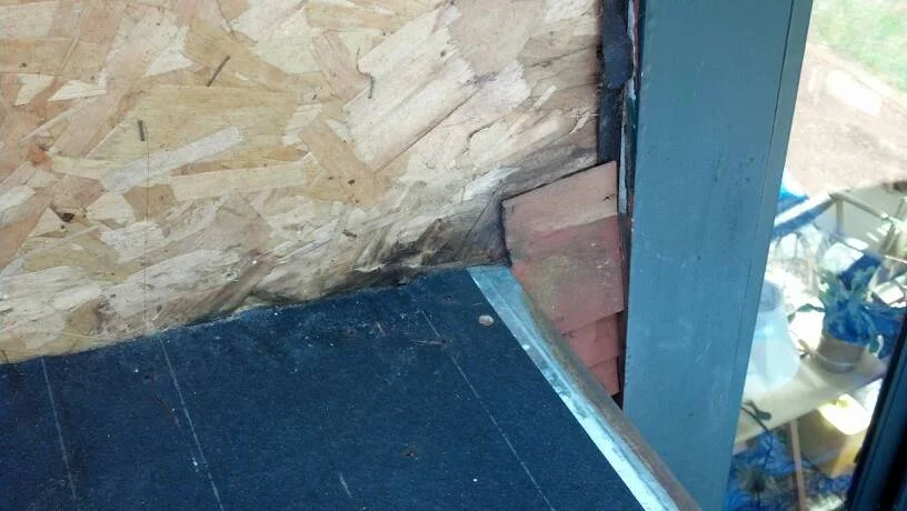

Sorry for not keeping this thread updated. Siding is all removed, I found all sorts of surprises when I pulled it off, I ended up taking off a lot more than I expected. I found most of the time I could ease up the plank, sometimes the nail would start to come out, but a lot of them just pulled thru, cedar is so soft. I got every piece off without breaking any of them.
Turns out the person that put this shed on (I think it was PO) didn't know how to do this type of roof. Who can count all the mistakes in these photos? Ya lots of mold and some rot in the wall sheathing. I had to cut out and patch some of it with plywood, plus replace one rafter and half of the roof sheathing.
I hate OSB, I would never use it if I was building new.

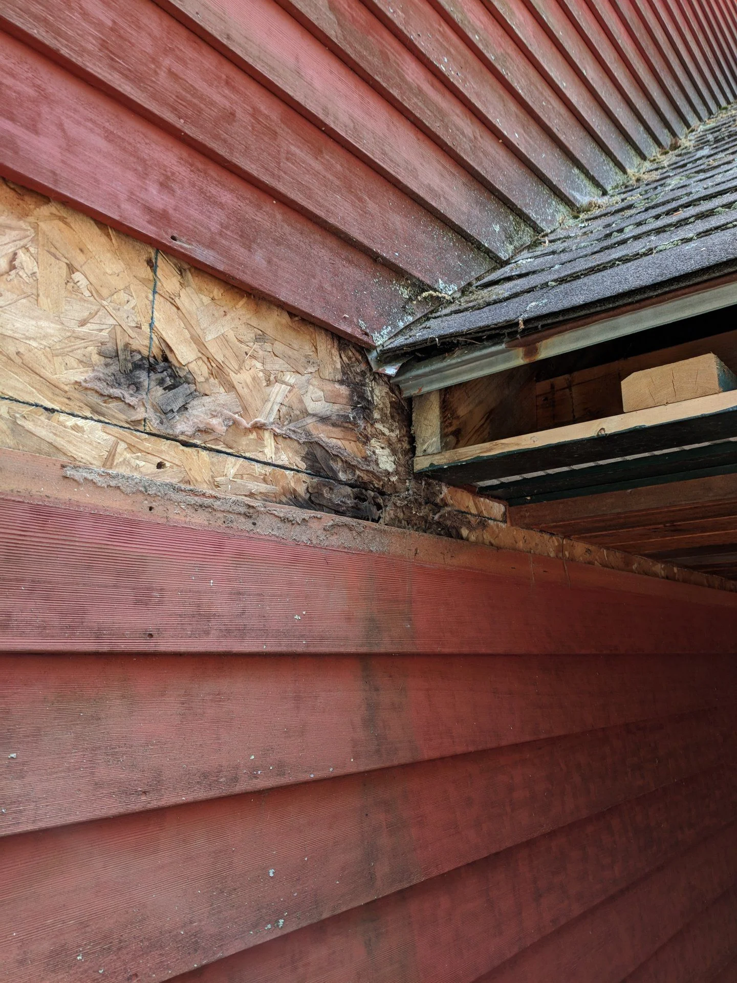

BTT. More fun fixing poor flashing mistakes. Now I'm on the front of the house, where the fascia of the mud room hit the wall of the main house. Poorly installed gutter. Got the rotted fascia off, sheathing was mushy. Great. Here we go again.

Suggestion to make a diverter at the wall, roof to gutter interface.
That way all of the rain water hitting the siding then runs down to the roof flashing and then directed into the gutter.
Here any projects being done we have to rain-screen the house.
There was a tiny "kickout" to try to push water away from the siding, you can barely see it in the photo, but too small. I'm finishing up putting it all back together today, had to cut out a 2' x 2' chunk of sheathing, replaced with plywood. Totally covered with flashing tape now, new fascia/shadow going on next.
Roofer is coming on Tuesday for a new roof, I'll make sure they put a much better diverter back.
I only pulled 7 courses of siding. Wouldn't all the siding have to come off to do a rain screen?
@ klf, when that roof and siding goes back together, make sure the lower end of that bottom step flashing is draining out on to the exterior of the siding. also, a piece of step flashing overlapped by starter metal and that bottom step flash after the siding and fascia are installed will go a long way in keeping water out of the wall. that scenario you have there is a money maker for me
