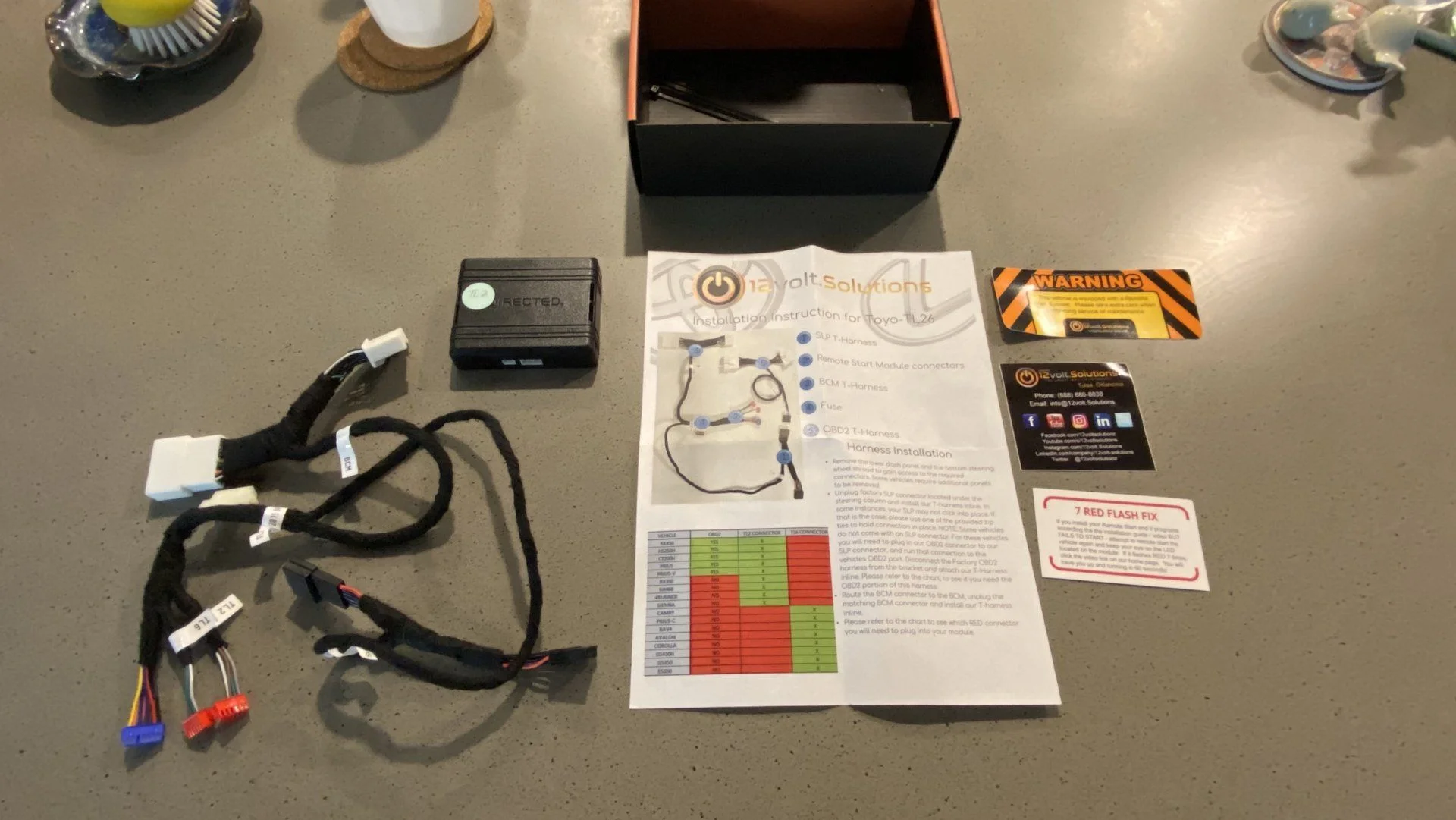

Anyone have any ideas about getting just the V4 harness for the RES module? The modules are cheap cheap used, but dont appear to come with the harness...
I’m using the 12Vsolutions setup and for ~$200, I’m very happy with it. Plug and play, so like the option you’re considering but piss poor directions included, but you can figure it out. Easy to undo if ever an issue. Overall, recommend.
