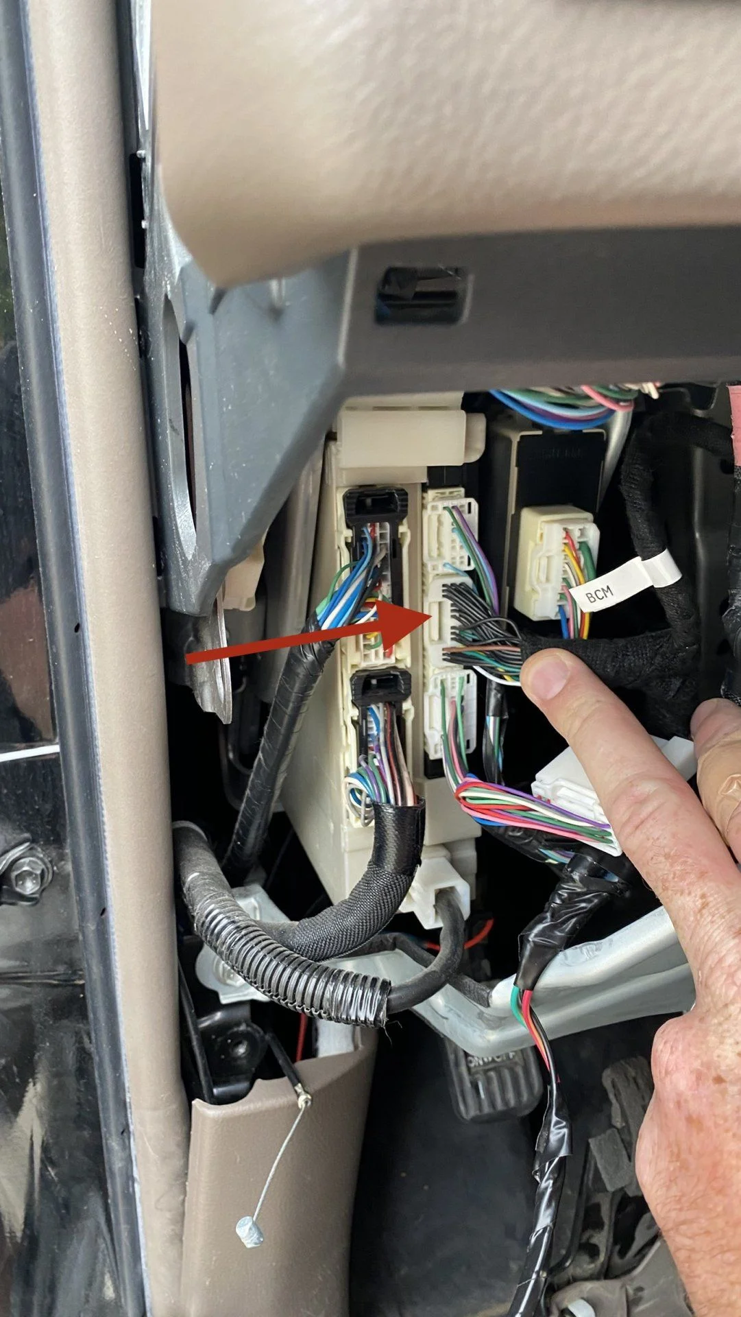

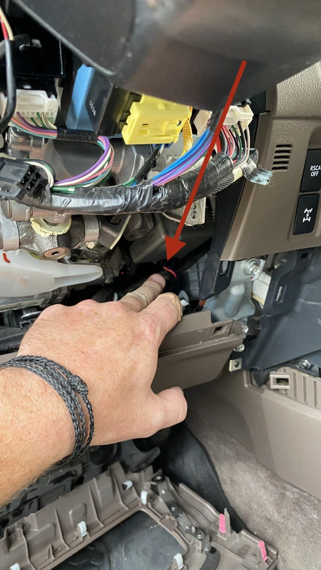

You’ll only use two of the three: the BCM connector and the SLP (TL2, disregard the TL6). Here’s the harness and what comes with the kit:
Here’s the BCM connector, left of the steering column and behind the lower dash panel.
Here’s the SLP or TL2 connector, right of the steering column and behind the lower dash panel:
Plug both those in-line with the factory wiring harness and then plug the supplied harness into the control box per their instructions.
Do a little button push programming and bam, you have remote start that works with 3 lock presses on your factory key fob.

Thanks JM. I agree the instructions are atrocious. How did you get to the BCM panel? On a taco thread it shows pulling off the side carpet trim and lower driver side outside panel. However, in your pictures, it looks like you got to the BCM just by removing the below steering wheel panel. Can you humor me and be a bit more specific which panel and how you need to remove? I did this in a 4R but this intall seems a bit different. Thanks!

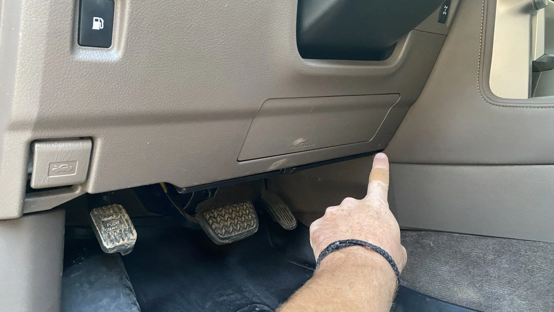

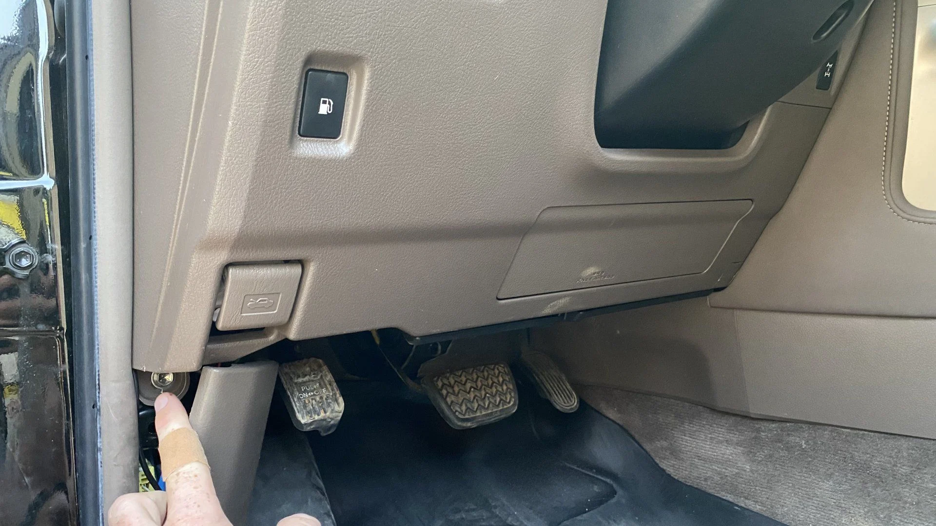

I wish I had clear instructions for how to get to the BCM, but I took apart a lot more to redo my ditch light wiring and such.
Best I can tell you is to remove the lower panel under the steering wheel and it’s on the left. There’s two hidden bolts, one behind the kick panel and one behind a flap on the right side. Remove those and pull, if anything snags, see what and remove it. Top half of the panel will just pry out.
