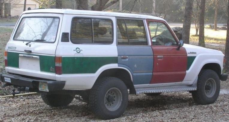

Reading throught this thread I thought to myself, "I don't know enough to have pulled off any of these redneck fixes" and then I read the quote above. I never really thought of myself as having any redneck tendencies, but I think this qualifies!:
(And beelive me when I tell you that the entire run of drip rails and windshield frame were covered in duct tape and aluminum tape, spray-painted white (as were those doors shortly after this photo).
