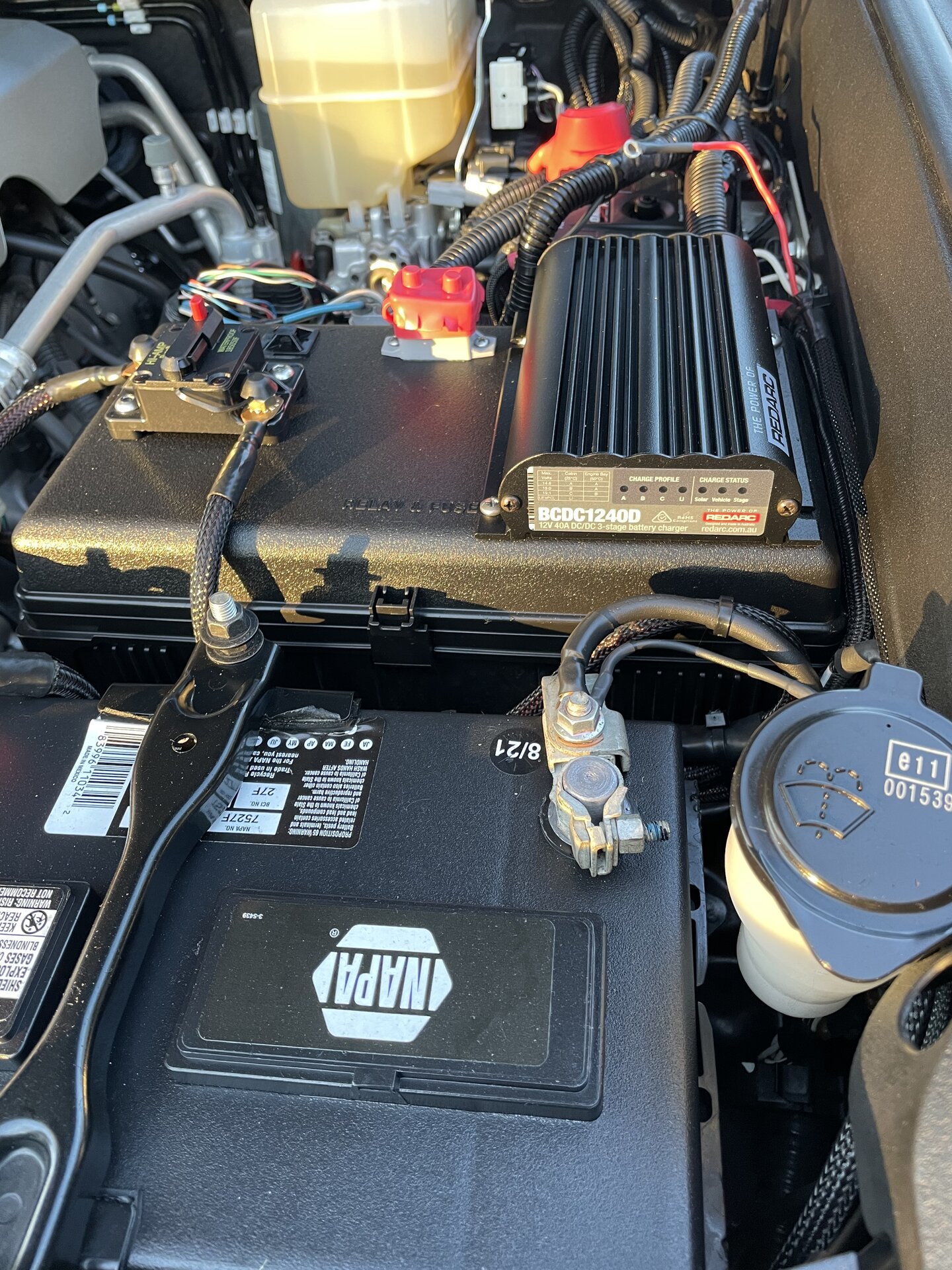

Hi everyone - I just received my 200 with the RedArc and 3 batteries, two in the engine bay and one Litium Ion in the trunk. The Li light keeps blinking red...I charged the main battery with an external charger and drove it.
My Spod won't turn on, the installation looks very clean. I can post a picture, any help would be appreciated.

Have any photos? Your description is pretty vague. Do you have power to the SPOD? Do all fuses check out good?
The lights don’t change whether the car is on or off, the Li just keeps blinking nonstop. I

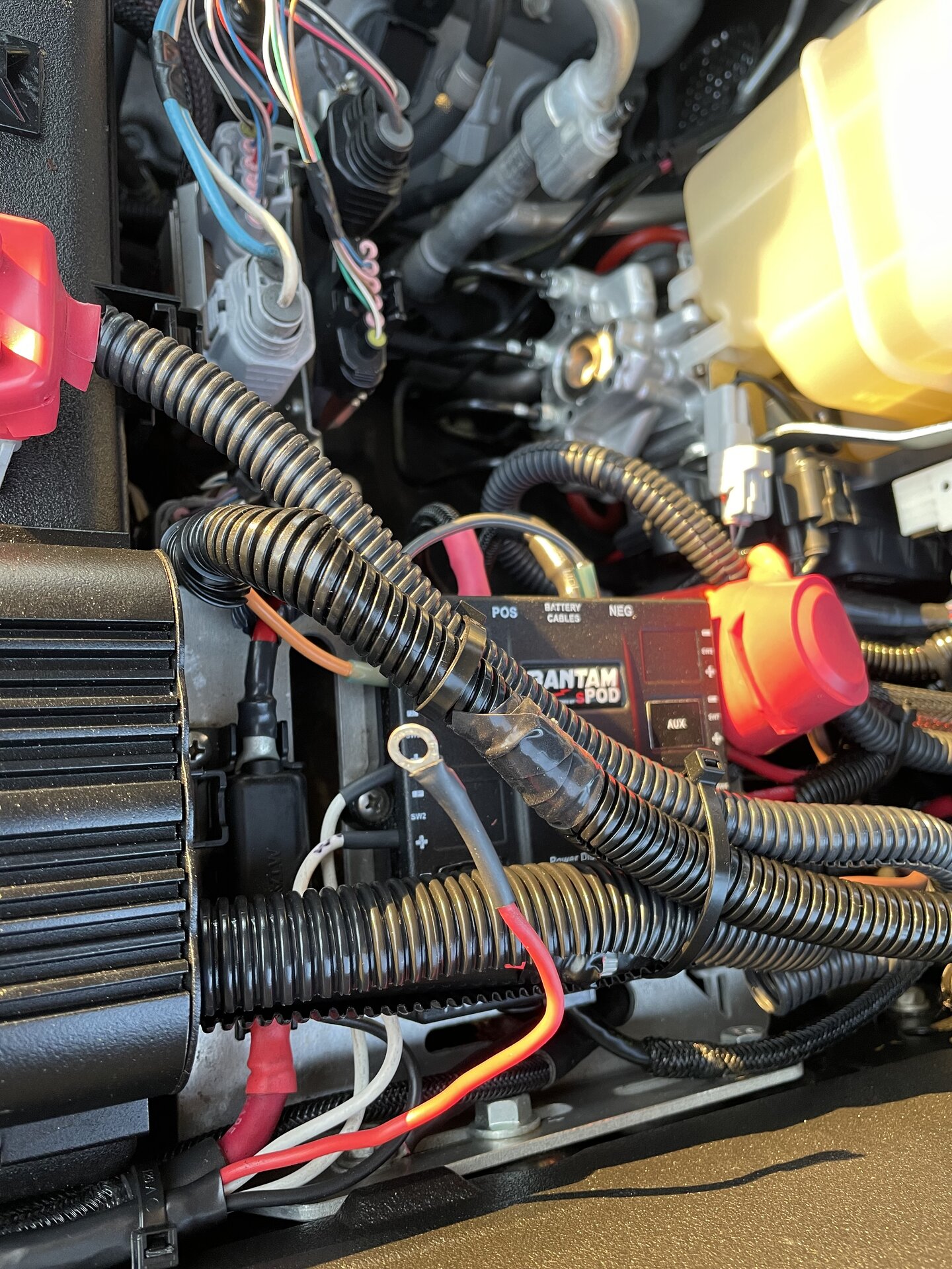

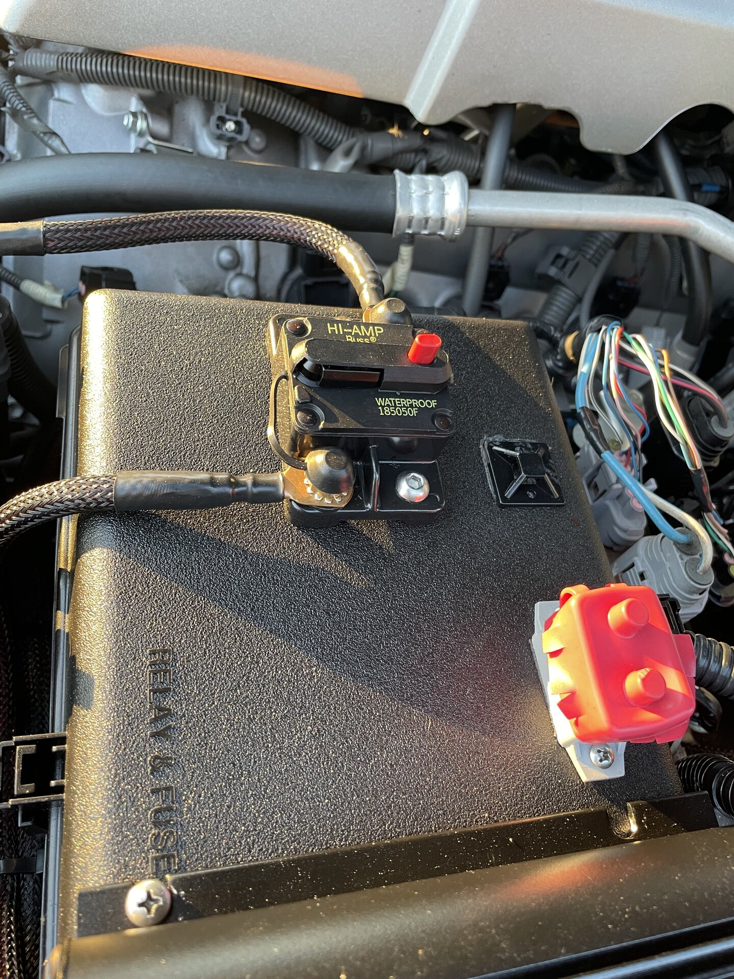

Here are some pics. Thanks for the assistance, appreciate it!
No power to spod, i unplugged and replugged the RJ45 looking cable from both the spod and the one under the hood.
It’s a 1240d. I did unplug the Li cable in the trunk, no change.
Which battery is set up to get charged by the BCDC? If the Li-Ion is the only one being charged by it, is the profile wire set correctly?
The AUX and the Li, I think the issue is that it was fully drained and this is a security mechanism. I need to add more juice to the aux to get it to "restart"...
I need to figure out where to plug in the external charger...don't want to blow anything up. It don't see the standard battery red/black.
I would put a charger on the actual Lithium battery in the back some where rather than trying to go through the charger.
Use one that has the right profile for lithium.
The Redarc will not function if the output battery is below 4v. It will just be off...
If there is a fault, it looks like either battery, Solar or all lights can indicate it (just reread the manual) - 1 Flash followed by 3.5 sec off is an internal fault which could be bc of the house battery being totally flat below 4v..
Normally the Vehicle light will flash faintly when it's in standby and the car is off... that is normal.
Redarc wiring
Red - To main battery +
Black - To chassis Ground -
Brown - Output to "House" battery (the lithium in this case)
Yellow - Solar Input (uses its own separate ground btw)
Blue (thin) - Unconnected for a LC200
Green & Orange - Connected together for Lithium profile
This.
I was chasing a weird issue and finally arrived at the fact that the house battery was simply deteriorating (then dead) and not taking a charge anymore. Occam's Razor and all that.....
I got it working, spending 2 hours with RedArc didn't help. I plugged my NOCO into the Lithium Ion and put it on the Li mode, it started charging. Turned on the car and both the Redarc and the Spod is working now.
Thanks for all the help everyone!
