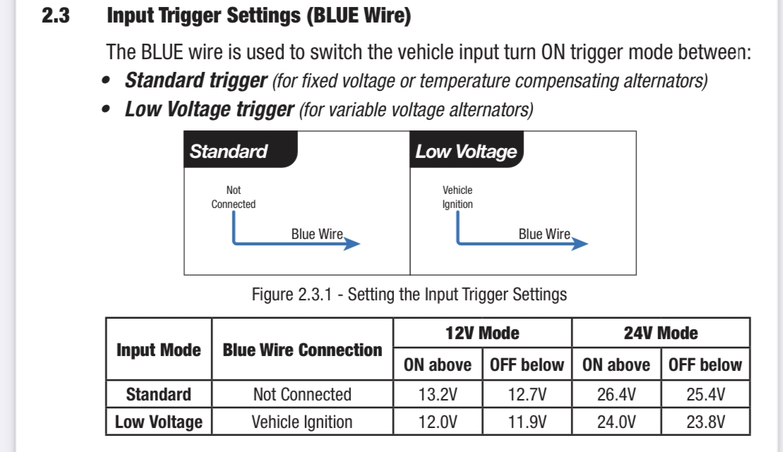

The blue wire controls the vehicle input on trigger mode setting and has the following impact:
In our land cruisers, we have temperature compensating alternators, so the blue wire should be not connected. Can you visually verify this in your install?

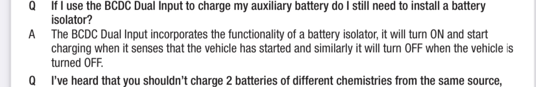

My take is that while it isn't strictly required as the REDARC senses voltage it makes an assumption that nothing is altering the voltage like a charger. In other words putting a charger on the starter battery confuses the REDARC. Usually that's a great assumption.
The blue wire however says do not charge when there is no voltage on it. So, if you want to be able to charge your starter battery per the video and NOT charge your 2nd battery then connect the blue wire to IGN. Seems to me that connecting Blue to IGN will do no harm in any case no matter what kind of battery you have.

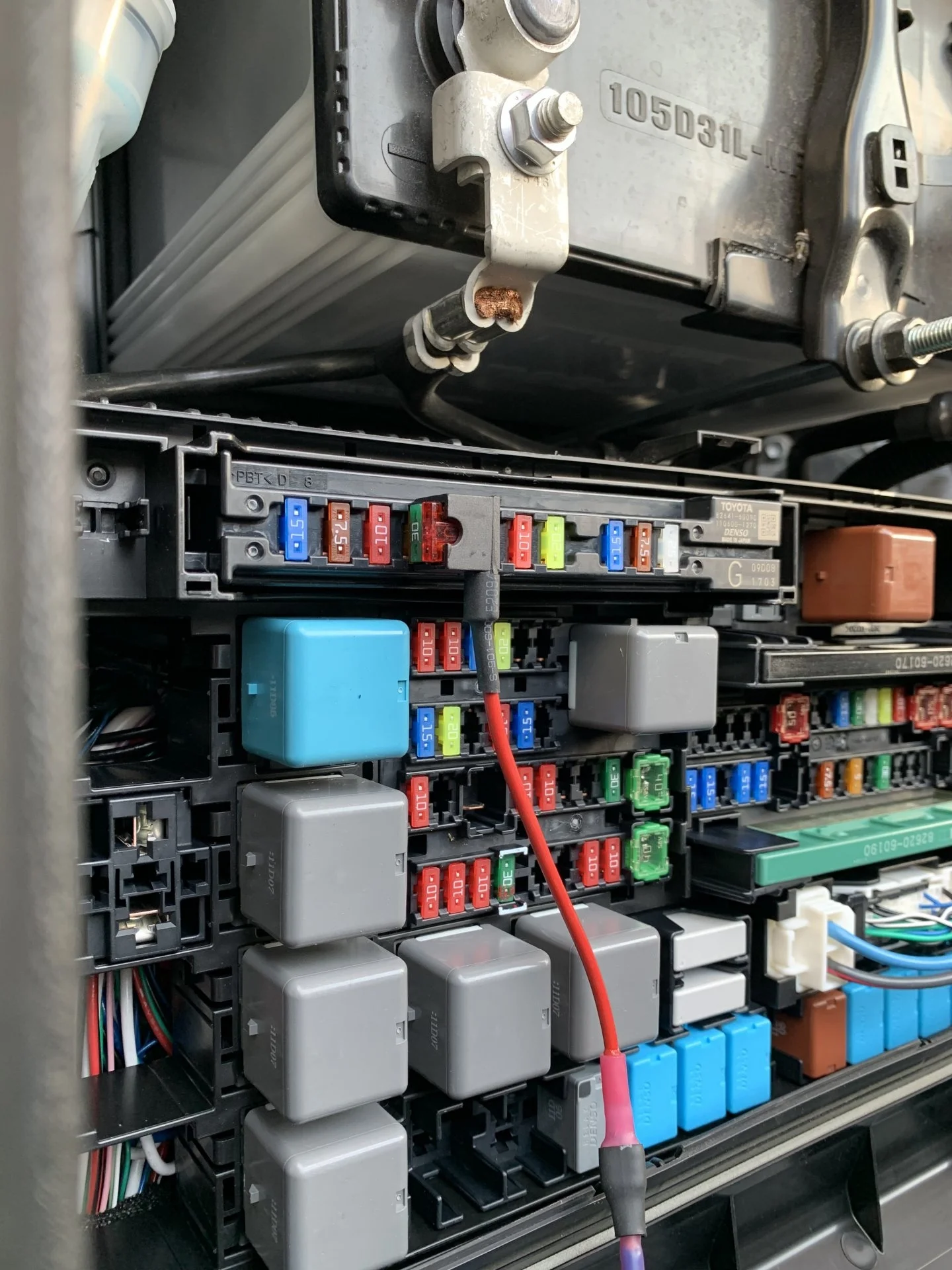

Now taking CharlieS’s suggestion I have tried to see if the blue wire is connected. I think it is.
See the pics below.
I believe that red wire is spliced on to the blue wire coming out of the redarc.
Thoughts?
That doesn’t seem right to me.
I’d ask the guys at Duggy’s why they did this.
The Redarc installation manual says to leave the blue wire disconnected for vehicles with voltage sensing alternators. The Land Cruiser 200 has a voltage sensing alternator.
One more thought - I’d make sure they installed your rear cigarette lighter to the auxiliary battery. That add-a-fuse could just as easily be to feed 12v power to the new rear cigarette lighter circuit, which would also explain a draw on your primary battery.
You could easily pull that add-a-fuse out, replace it with the proper amp fuse for that location and retry your lightbulb test.
1250 Manual for reference:
