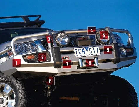

No jacking points? ARB even advertises their jacking points on the Deluxe bar. Sahara no have?
" A number of recent ARB heavy duty bumpers incorporate Hi-Lift jacking points neatly positioned in the center pan, allowing a Hi-Lift jack to be mounted directly onto the bar and eliminating the need for a mounting bracket. These points also enable easier access to the clutch lever when unspooling the wire rope before winching.
Hoser,
Nope, no dedicated jacking points on the sahara like the ones pictured (7) in your post. That was the reason I cornered the rep at to show. Also note there are no recovery points for a shackle in the picture either.l
Ah, the last time I looked at my Deluxe bar, the area around #7 was also double walled steel.
