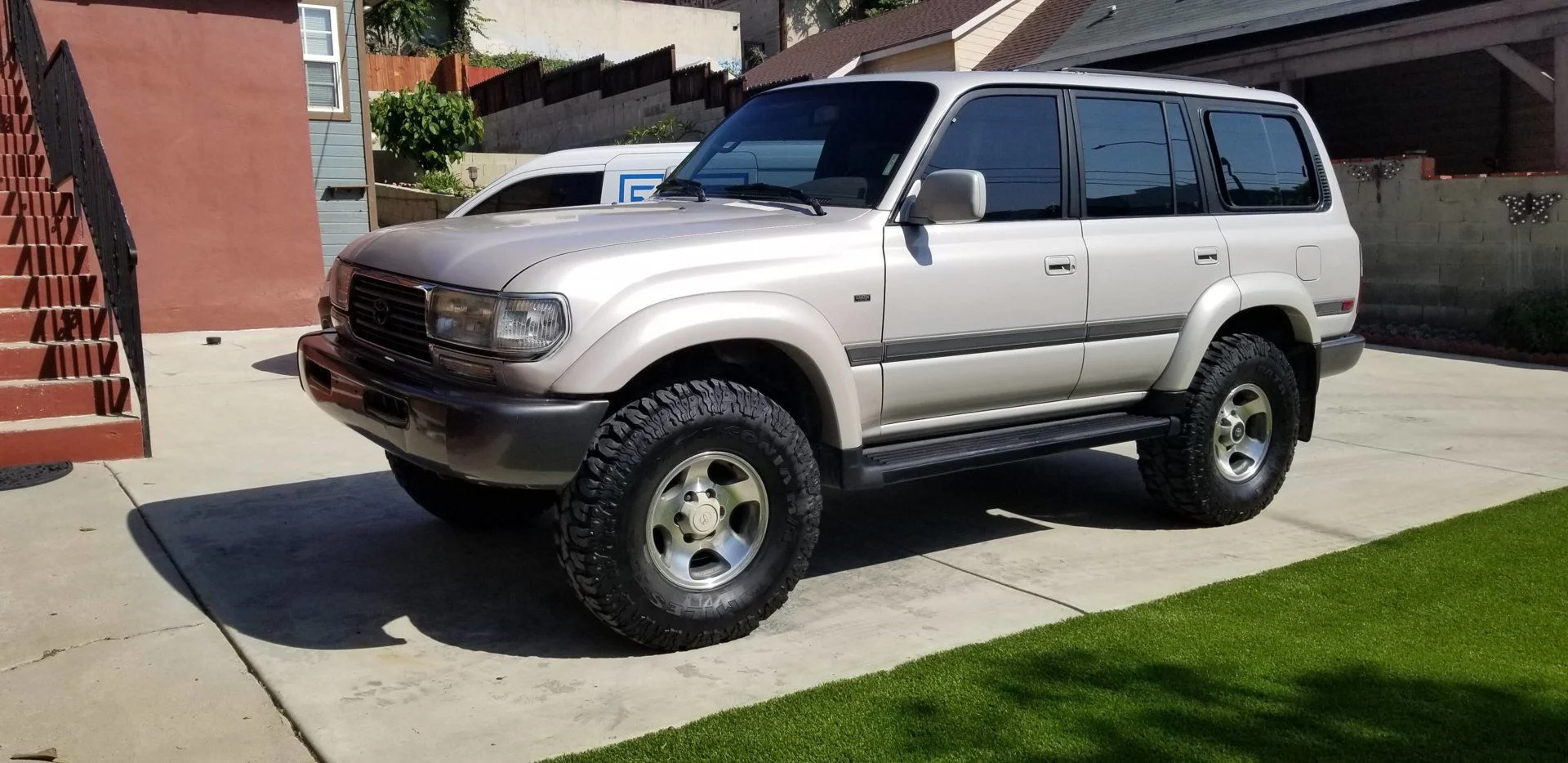

Hey everybody, I've got a tire question that I can't seem to find has been discussed previously on Mud. Currently on my rig, I've got a full set (including matching spare) of 285/75r17 wheels and tires that came with the rig when I bought it, however I am wanting to go with a little bit bigger/wider of tire.
Ideally, I would like to go with the typical 80 set up with 315/75r16 however the cost of wheels and tires will easily exceed $2,200. Assuming I can sell my current set up for around $600, that is still a lot of money left to spend, being a college student.

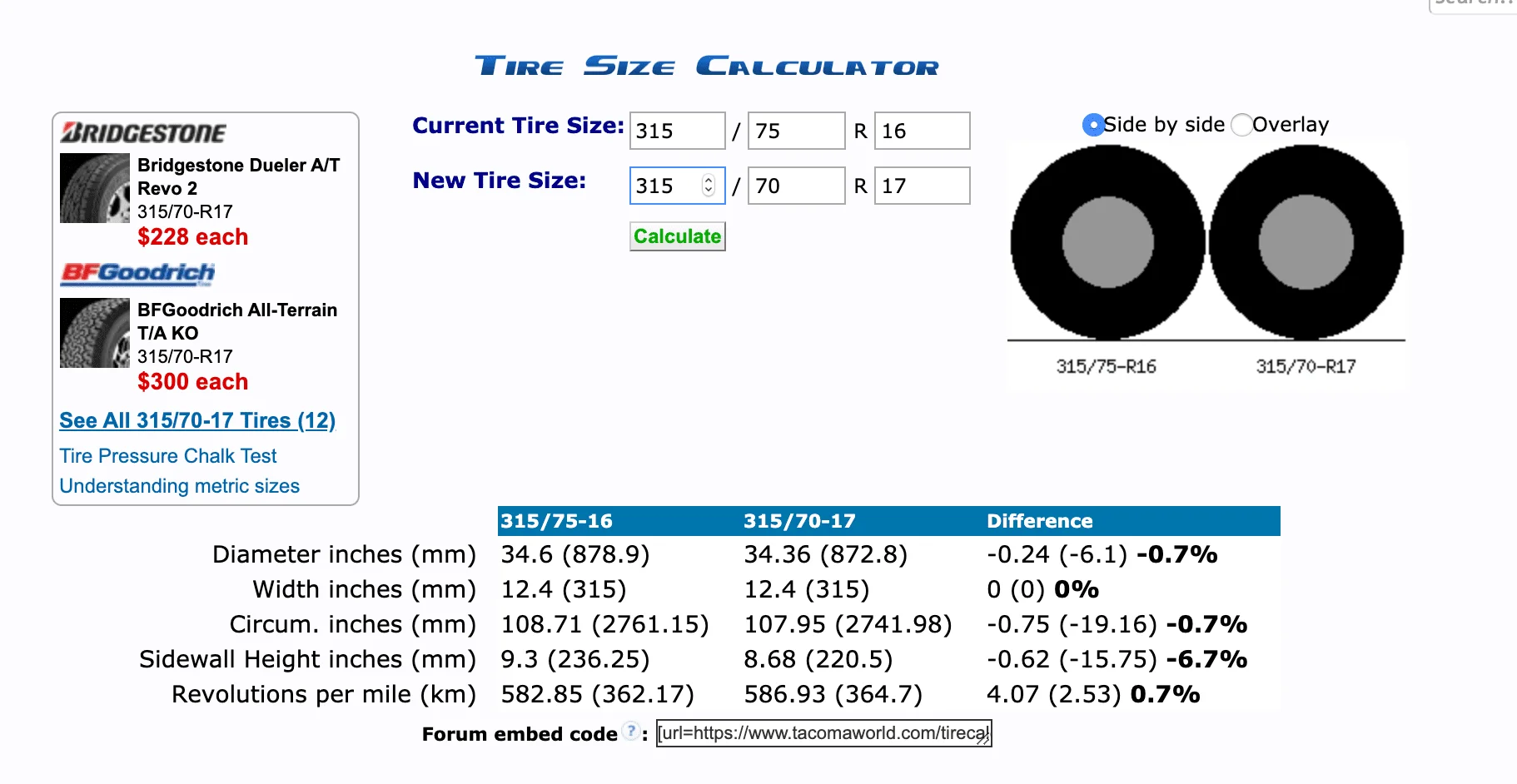

An option I have however, is to just get new tires, 315/70r17 and save money on having to buy new wheels but it is not necessarily my preferred look.
Does anyone have experience with 315/70r17 tires on an 80? They are extremely comparable to the 315/75r16s and would be a significantly cheaper option and I don't think I have a year / year and a half left on my current tires to get by until I graduate and make enough money for my "ideal set up".

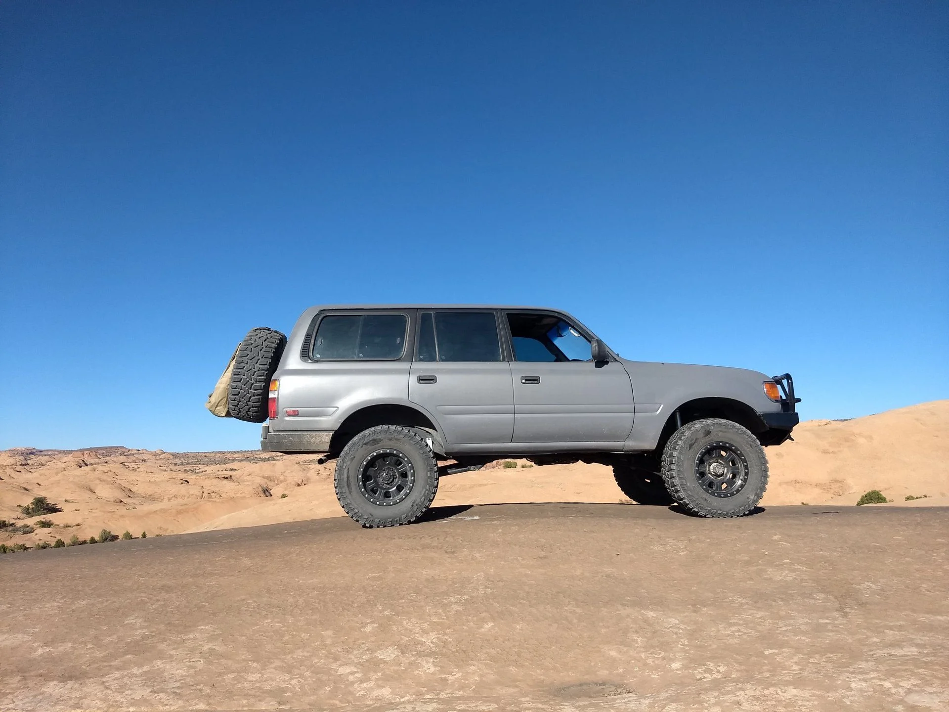

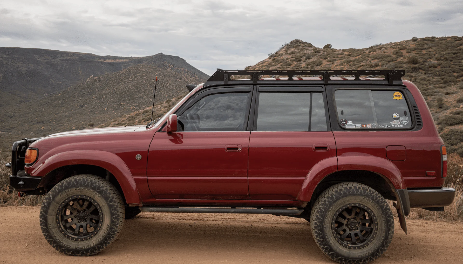

check out @Arizona Jeff - he's rocking that setup. and can answer your questions.
I think your wheels look good and recommend keeping them. I have factory 16” wheels with 315’s. If you want to go to factory 16” wheels they pop up on craigslist from time to time. Here‘s 4 for $400 Currently listed.
i’ve seen many times where people want to go from 16 inch wheels to 17 inch wheels. Maybe you could get someone to do a swap with you.
With my rig I invest more in performance and less in appearances. If I were you I would put that wheel money towards better tires or towards a rear bumper (yours looks factory). Best of luck.

I saw those wheels and was considering it, but I like the look of black wheels and once I factored in the cost of powder coating OEM wheels black I'll be right about where I would have spent for the aftermarket wheels I was looking at. But yeah, I definitely believe I'll be better served just upgrading my my tires for now. The rear bumper plan is in the works and is likely going to be a present to myself once I graduate college and get a "real job". As there is no conceivable way I could afford/justify the $2,200+ for one right now with some of the other things I need to take care of. Thank you!
Just stay with the 17's if you like your wheels. I went away from factory wheels to get a little more backspacing. I paid $1136 shipped for 5 cooper stt pro's in 315/70/17. If your old tires are above 50% tread, you can sell them used pretty easily.
