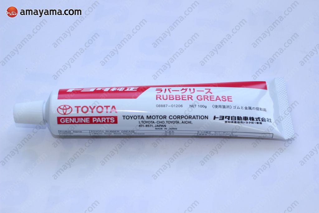

The small packets of red rubber grease you get in the rebuild kits aren't big enough, but you can order a tube separately. The rubber grease Toyota use is a Cosmo product, separate part number is 08887-01206.
The small packets of red rubber grease you get in the rebuild kits aren't big enough, but you can order a tube separately. The rubber grease Toyota use is a Cosmo product, separate part number is 47265-20050.
That sounds great. The part number pulls up a master cylinder boot on google though.
Maybe: 08887-01206

Sounds like it's another Molykote product like the "Toyota Body Grease". I'm sure there are plenty of things that would work just as well.
