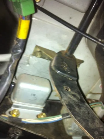

The master switch for the rear window is the key operated unit in the tailgate. The dash switch is secondary and you must have the ignition in the on position to have it work. There are no fuses for the window although there is a large circuit breaker under the dash to protect the motor from overload. There is also a relay for the dash switch that closes when the ignition is in the on position also under the dash. It's possible that the wiring or the connections from the dash switch are frayed or oxidized. The wiring harness for the dash switch runs along the PS door jams and into the PS rear wheel well. You may want to give it a quick inspection. Pay particular attention to the wiring as it exists the tailgate sill and bend up into the tail gate. The wiring has to bend at this point ever time the gate is opened and closed and could fatigue.
Under dash next to hand brake
Does the circuit breaker reset itself, or does it need a manual reset?
Auto reset. Give some time to cool down and you can hear it click.
