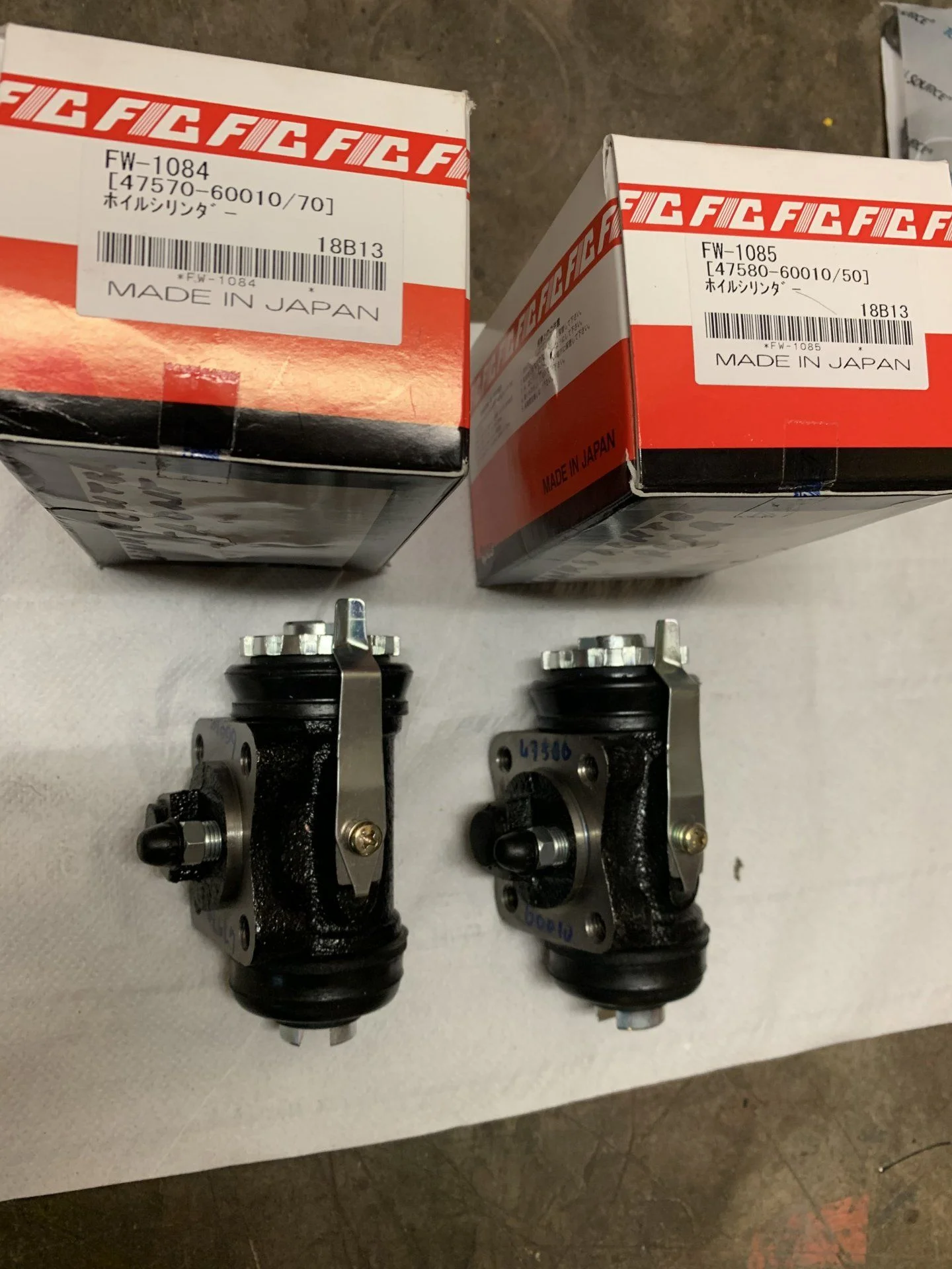

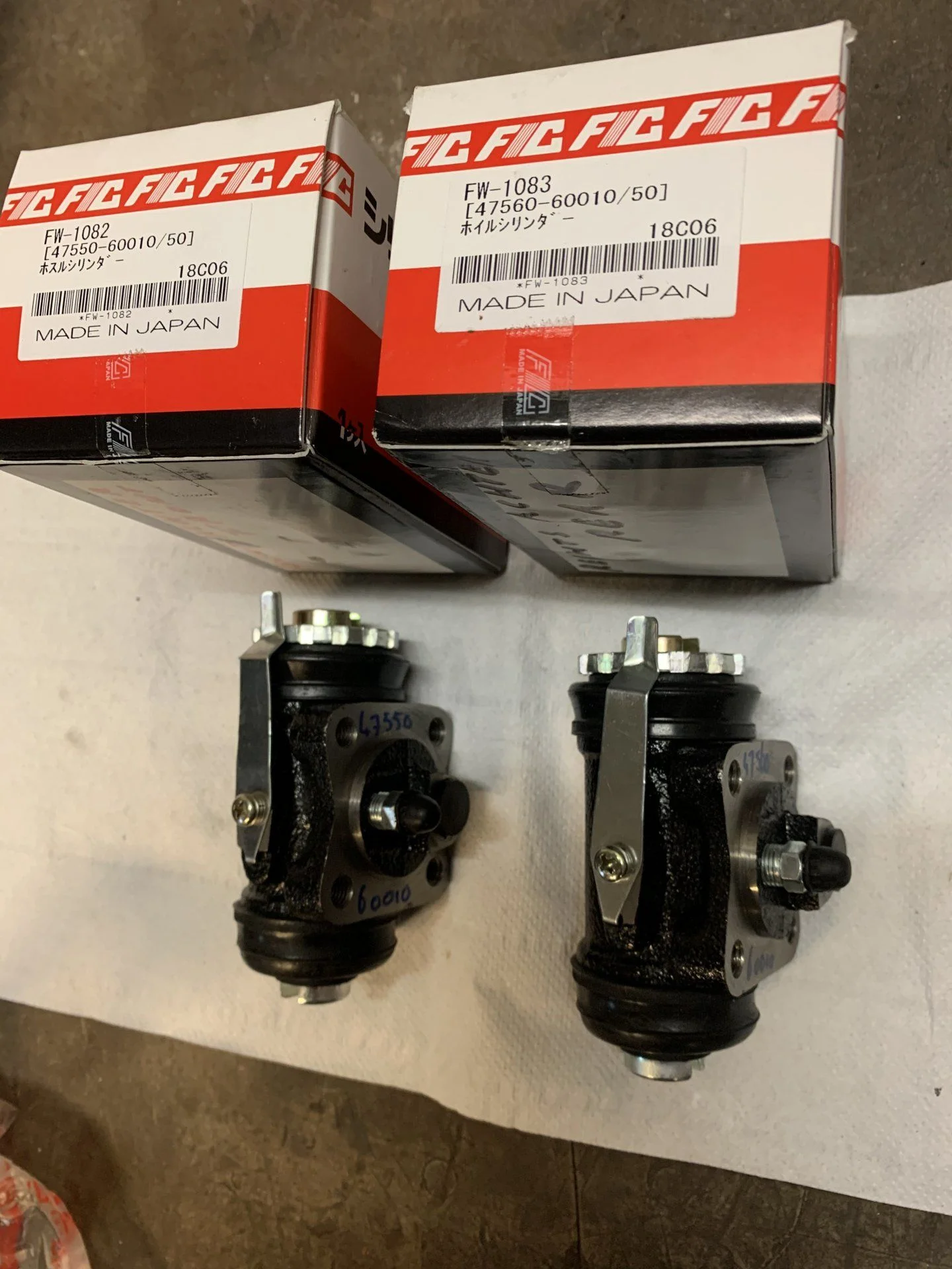

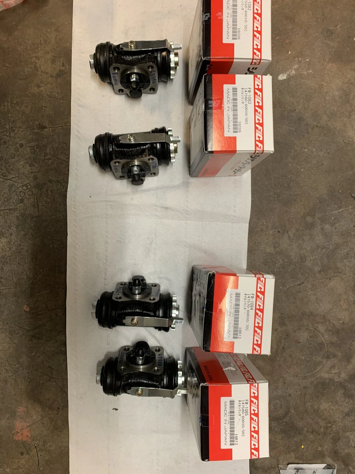

Got my wheel cylinders from @Racer65. I see he difference between the left and the right side. But what’s the difference between the front and rear? They look identical to me? They do have different partnumbers.
Tagging @65swb45 , Mark, I think you know?
When I have to look them up, I do. Usually I just let the rubber plugs on the backing plate guide me: oval plugs on the adjuster end, round on the non-adjuster end.
Toyota originally designated two different part numbers for each side because the cylinders were supplied WITH THE BANJOS, which differed from front to rear (in/out rear, in-only front). If there are no banjos, the designations are superfluous; in all other respects the rears on each side are identical.
