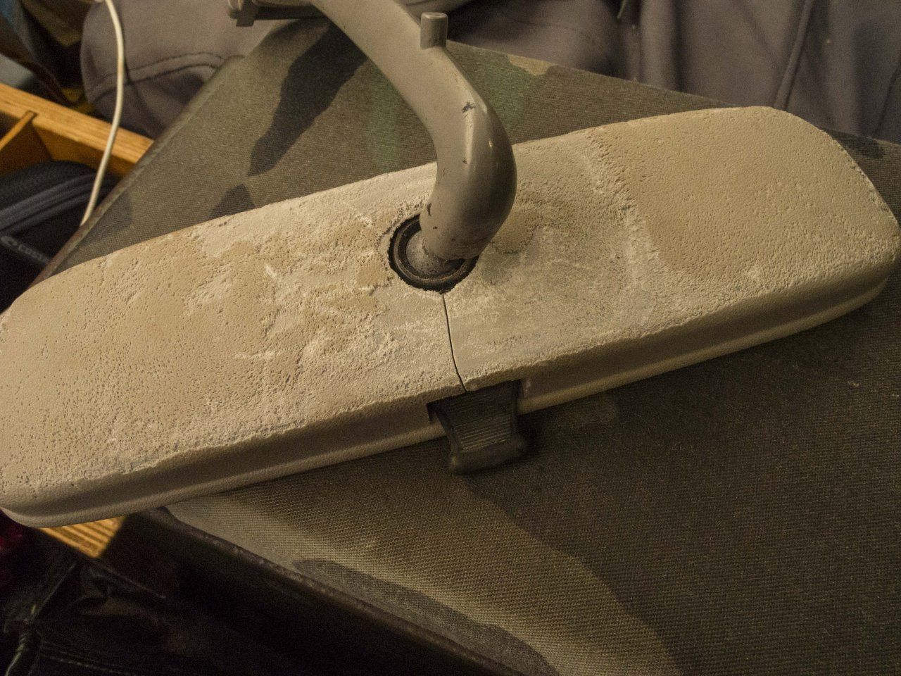

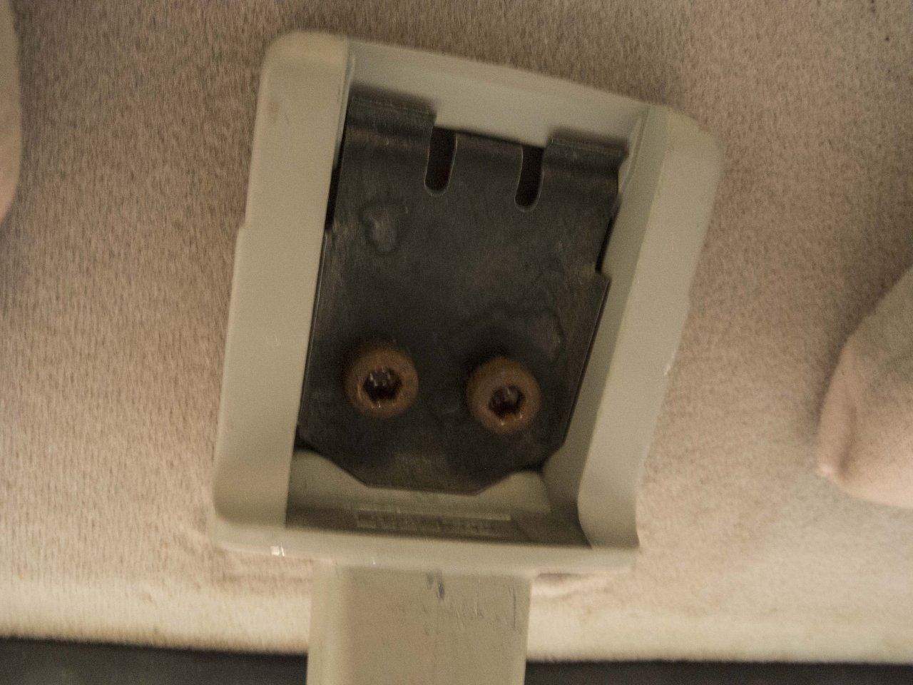

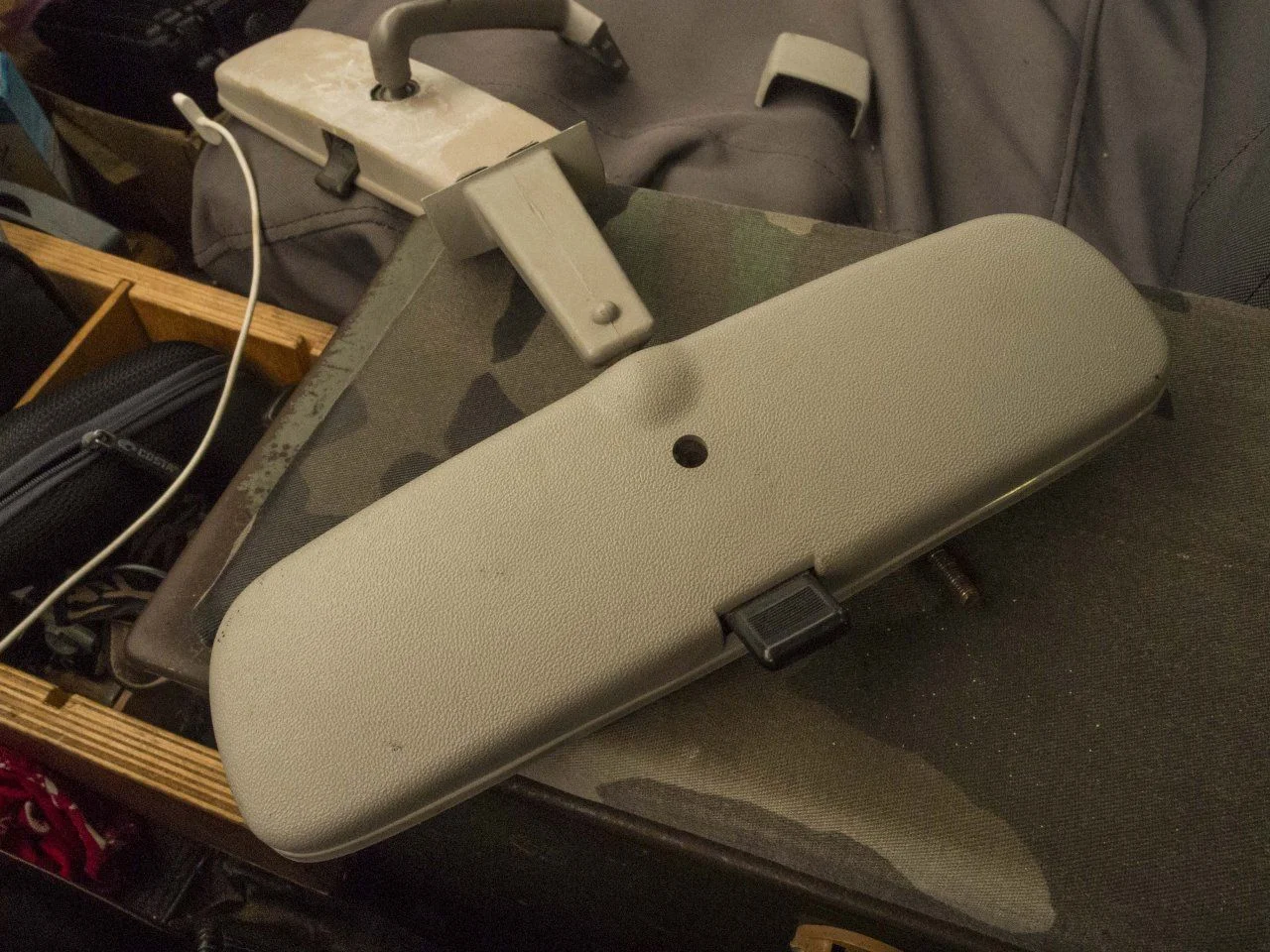

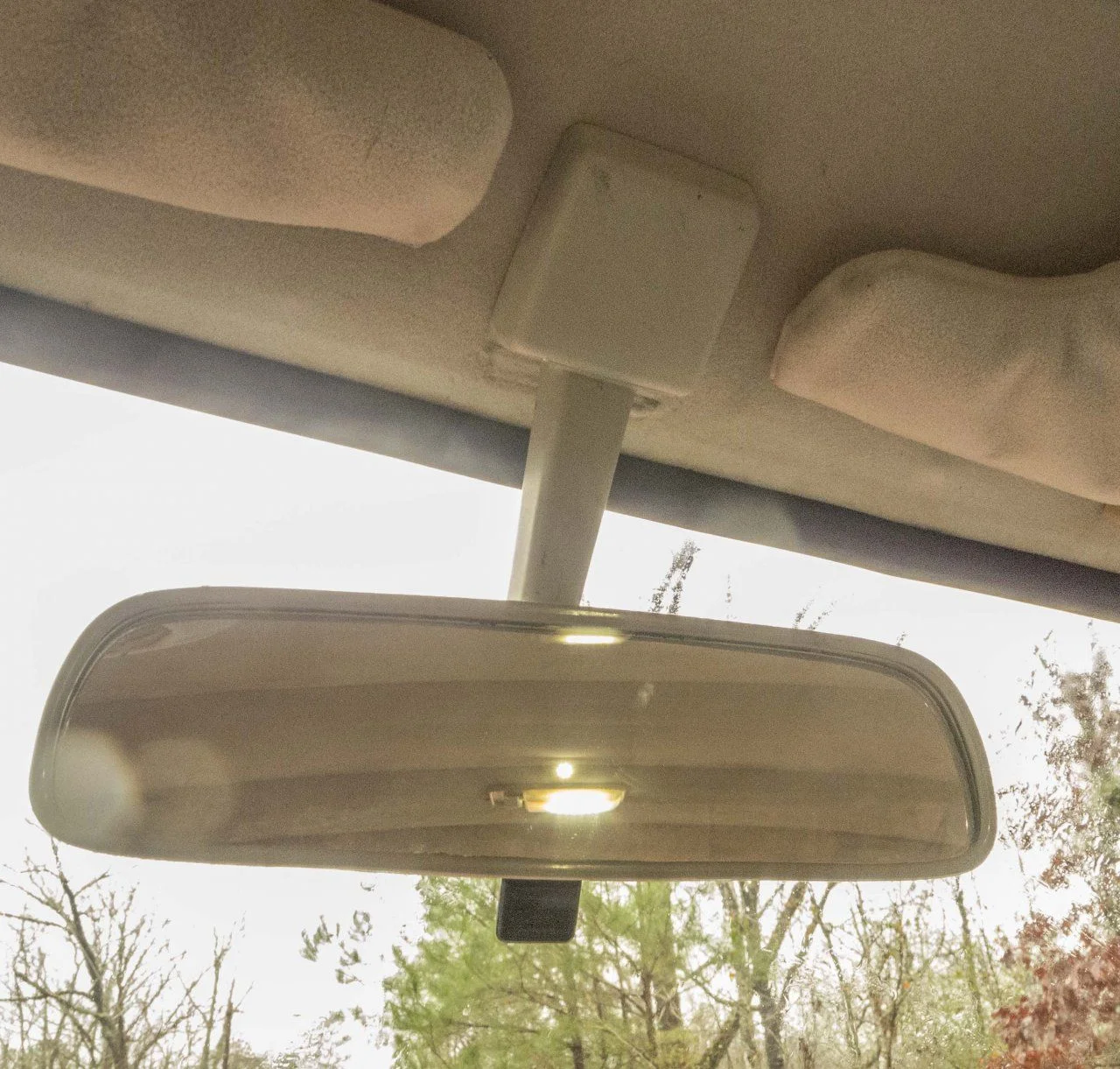

FJ60s inside rear view mirrors are beginning to show their age. Mine has been become brittle and has been slowly disintegrating. I was sitting in our 80 series the other day and noticed a strong similarity in shape, mount orientation, and angle between the 60 and 80 series. An 80 series popped up in the for sale section for $5 and I decided to roll the dice on it and test fit it in my 60.
Direct swap and here are the pics.
FJ60 mirror mounted.
Crumbly backside of FJ60 mirror.
Backside of 80 series mirror.
80 series mirror mounting base.
80 series mirror mounted in FJ60.
Nice. Is the 80 series mirror larger in any dimension? I wish my 62 mirror was taller and wider.
