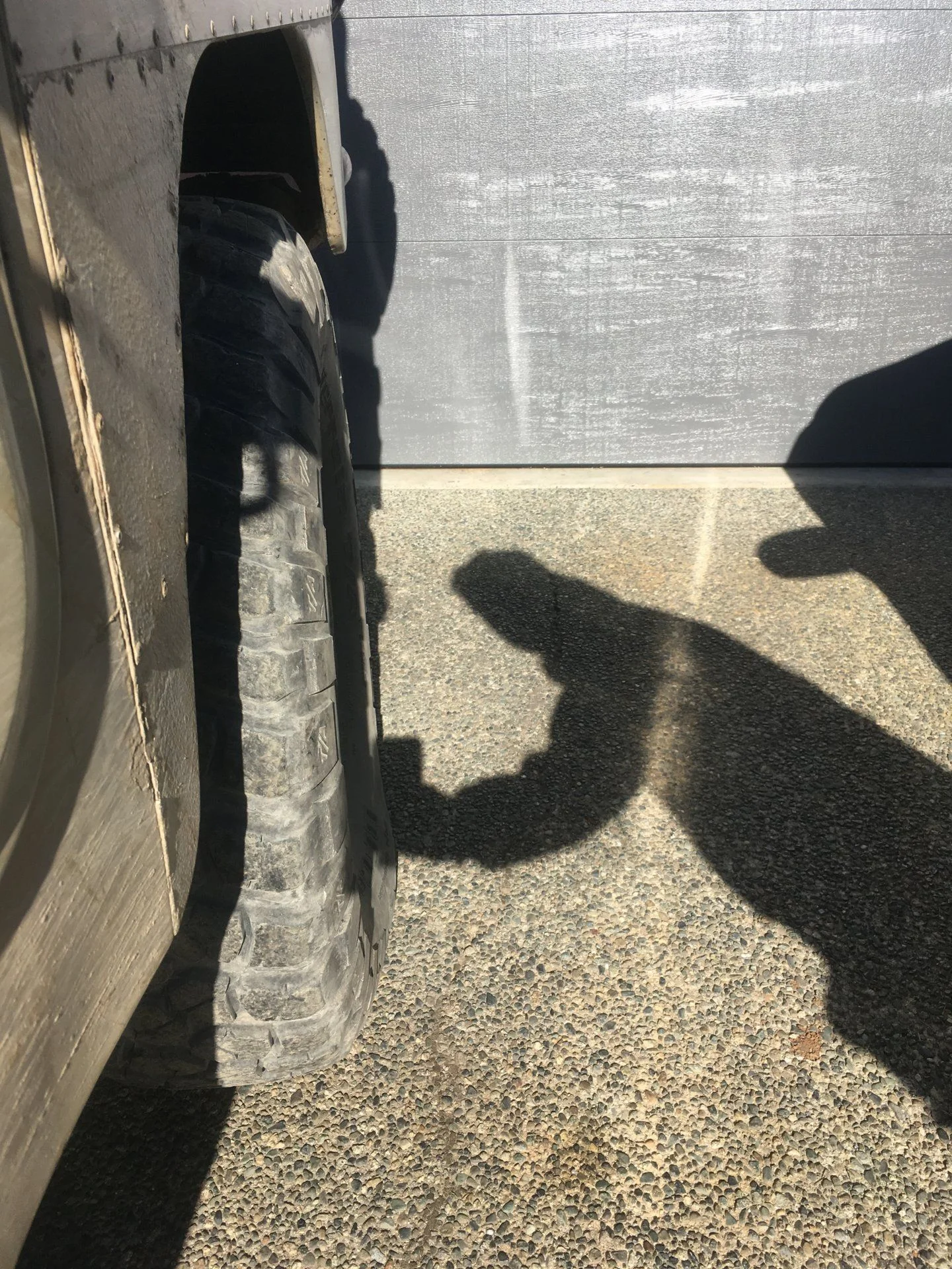

Been spending a few days of the week and weekends building a new trail with young Matthew...Then this happened on the way in. Had to remove drive shaft and get a flat bed to take it home as it was very unsafe.

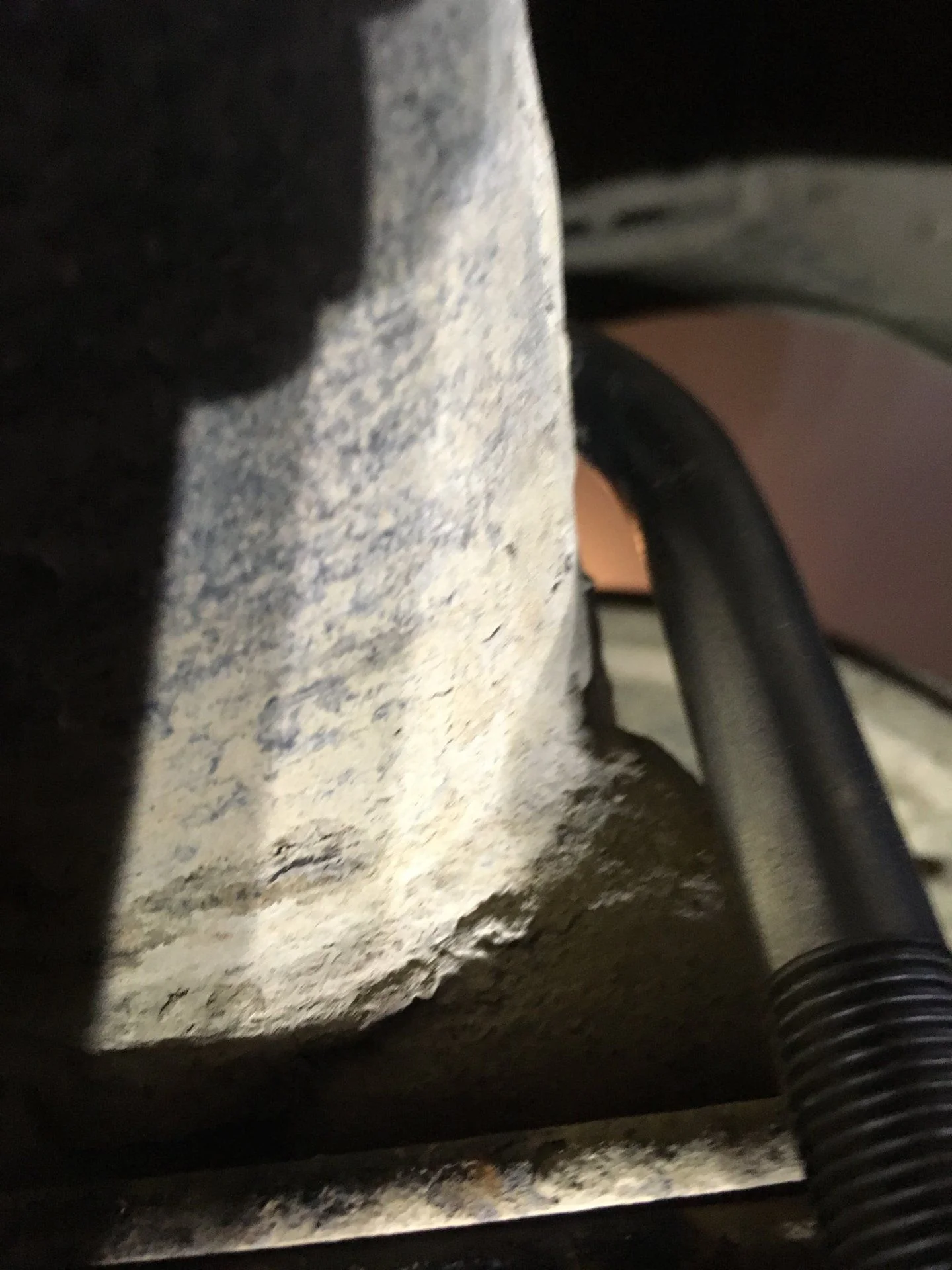

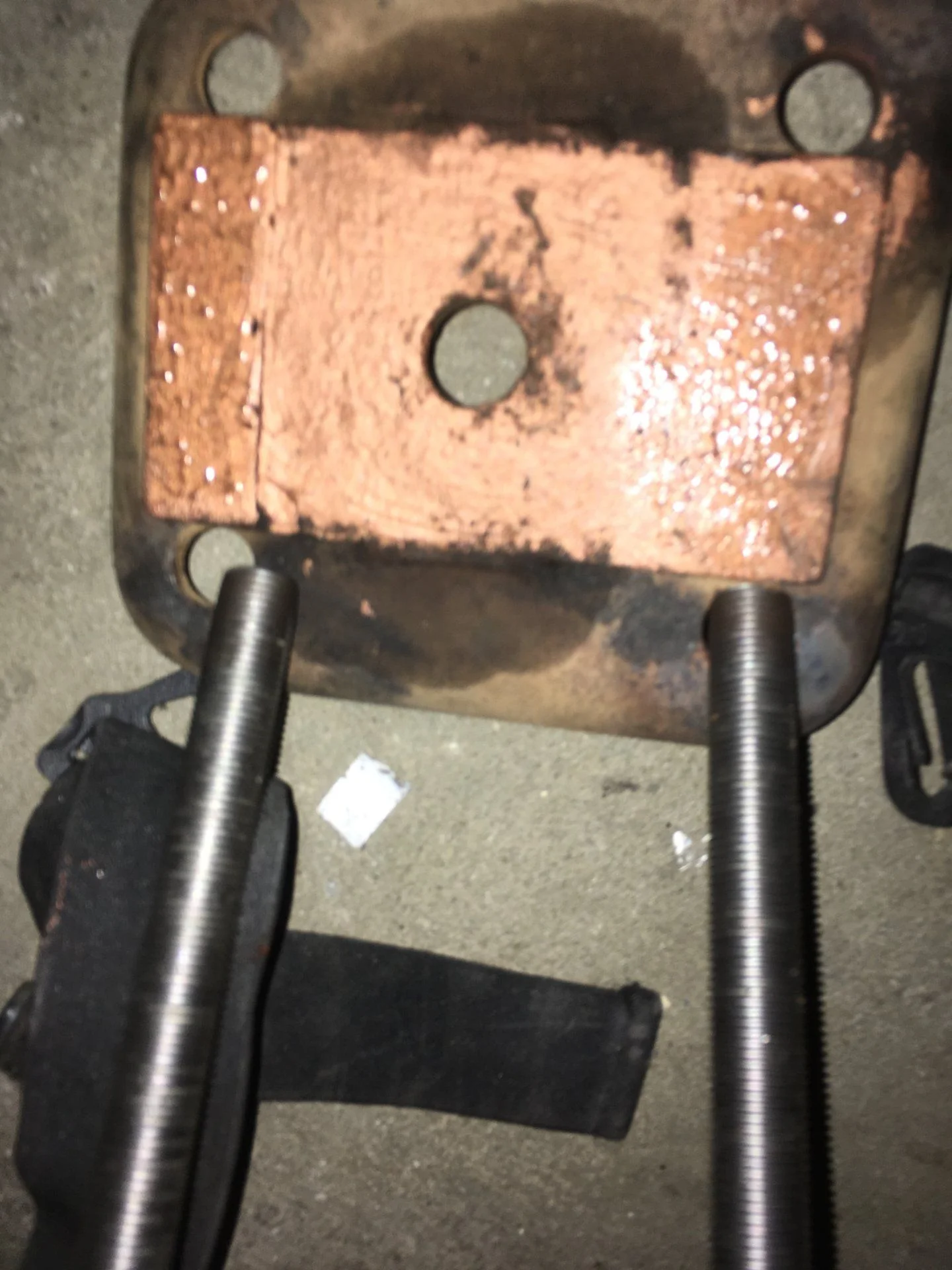

The ubolts from Hub City spring have been stretching and never seem to stop. I am replacing all Ubolts, fronts are also now stretch and the axle tends to rock when they get to loose.. In this case I had just torqued them again and went out and had the spring centering pin shear off thus allowing the axle to move back 4 inches on one side..
Some one pointed out my spring mounting pads may be round slightly which will cause this to happen even with new Ubolts. If so I will check and cut them off and put on the longer Ruff Stuff mounts.

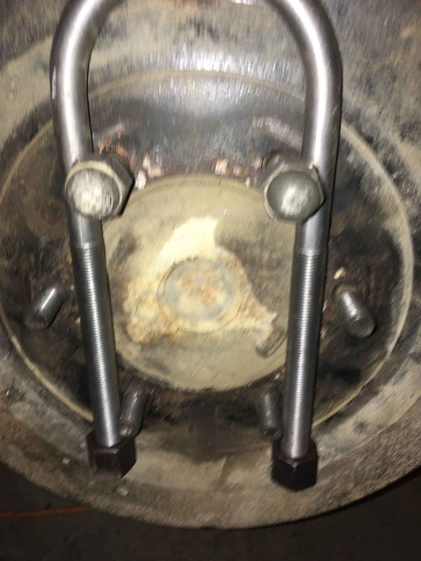

Problem solved..... hard to believe 5 years ago I gave HCS my factory ubolt and they made me up a set that were the wrong radius, yes they fit and bolted up easily enough.
This time around I got the new ubolts and within minutes of putting the first ubolt on I noticed how much room between axle tub and ubolt, around 3/8 of an inch.
Nearly impossible to open up a ubolt by hand, Island Spring made them quite a bit to tight, figured out how to spread them using impact and rear axle bolts.
I wiped off the never seize and ground and painted the perches.
