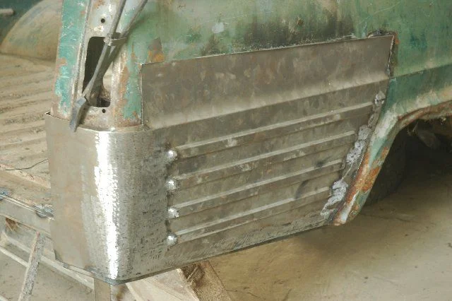

Here is the right panel being made and fitted onto the vehicle. We decided to make it larger so it can be dented from both sides after being welded in place. Your input on how high the pieces should be would be appreciated.
Ehsan

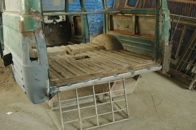

We have also made the piece that goes below the rear door. If anyone of you can post pics of an intact rear piece on a vehicle, it would help to see what the OEM shape is and what we need to change in this piece.
Ehsan
Those look Great!
My LV didn't come with the rear 1/4 pannels and I was fortunate to get some from BMAN.
One thing I wished to have were the wheel wells. I know this would significantly complicate your current design, but I think it would greatley benefit other LV owners to have a pannel that wraps around the corner and includes the part around the wheel well.
Also, to answer how high to go about the crease above the hightest rib. I personally would have liked to get at least two inches higher than the crease.

The wheel well can be made in a separate piece or in this piece if the shipment is a large one (300 kg +) so we can send it via sea. By air, it will not be cost effective to send the whole side in one piece.
Ehsan
I need urgent help and opinion regarding the size of the panel specifically its height. How high should the panel be. Should be as high as in the pics below.. This would alow the fitter to hammer on both sides of the panel.
attachment.php
attachment.php
OR
attachment.php
This high.
This has to be within the next 12 hours. If I dont get any opinion, I will go for the second choice. 10 sets will be in the making tomorrow.
Thanks
Ehsan
Ehsan
The piece in your photos is from an LV with barn doors. In the US and Canada all the LV's were supplied with a tailgate so that part will be a little different with the hinges in it. Hopefully someone can post a picture because I could use that piece but I can't get to my LV for about 2-3 weeks.
Will you also be making the piece that is under the truck across the back? I backs up against the one you've started on there.
