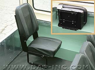

DAP in VT used to sell these foward facing jump seats I always thought interesting... i have seen alot of high back seats recently

Those Dap seats look awesome, though. Too bad I don't think they're sold anymore, but even still...
Those are sweet. I really like the forward facing jumps especially when doing much riding on the road. I had the long OEm ones which were perfect for our herd on the trail.
