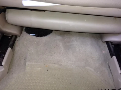

I went out there and snapped a picture for you. Does your under drivers seat look the same? The main ducting is not visible, the heat comes out from UNDER the inside seat slider rail. There are vents at the bottom of the center console by the 2nd row feet that also blow air but not as much. Circle thing on left is the blower.
Mine does have this but no hot air blows out of it. I just went out side and you need to select Rear on the dash to get air flowing out of the bottom vents of the center console. You need to select high from the roof selector if you want High airflow otherwise it defaults to low when you select Rear. The roof vents in the 3rd row only blow cold air.
So, by "this," you are saying you do have the blower and a high volume of air comes out front under the console but it just isn't hot? If this is the case, then I'd suspect you have all the parts, just something is wrong with the system?

Even though I technically have rear heat, its not the separate unit that sits under the drivers seat with the controls on the aft of the center Console.
I would think you could easily add this option to a not equipped truck but I was told by cruiserparts.net that it would require a lot of custom work to make this happen.
Looking at the ducting I could see this being an issue. Might need to install a small electrical heater somewhere in the third row with a swtich mounted up front for control.
If you have the blower, you likely have the separate heater core because they are one unit.
