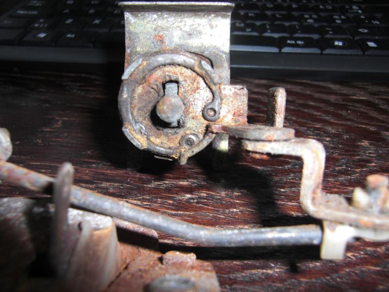

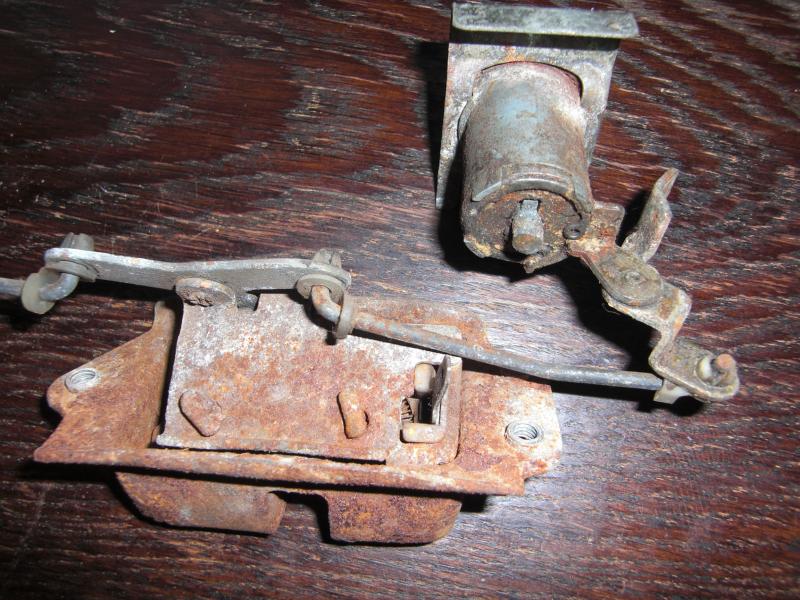

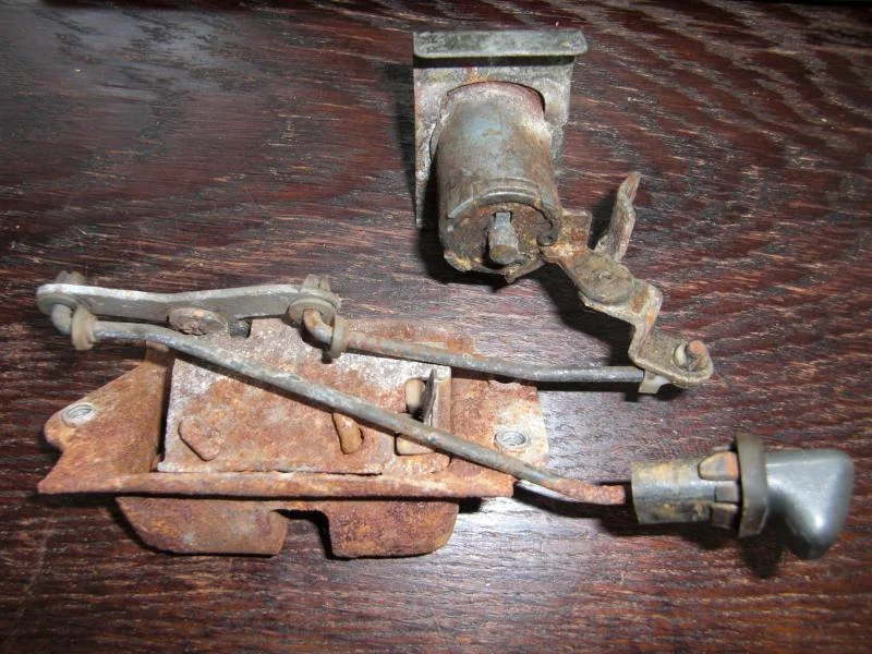

Pics enclosed.
The inside button & metal wire that connects it to the latch is what used to be a rope when it was all working.
I am able to open and close the gate from the inside including the latch... just not from the outside. The outside button and lock is not secure.

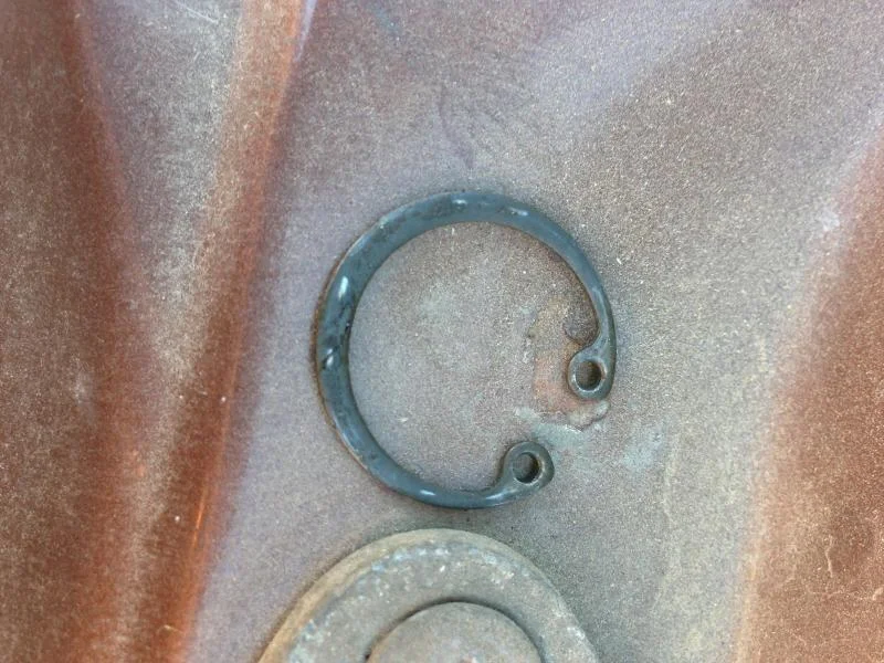

It was pretty clear to me that I was missing some kind of clip that holds the spring in place. After looking around the inside I did find a clip just resting next to the inside of the latch (photo enclosed).
I'm not entirely sure which piece is missing (if any). I haven't been successful in finding a good close-up diagram.

Here's some pictures from my donortruck backdoor lock,looks like your's is missing the plate/hinge that holds the spring in the cylinder.CIMG5439.webp
sweet, that works. thanks sved, now I don't have to open mine up, and you are definitely missing that back plate and it appears the plastic clip conectors to the metal rod too.
for those parts, I would highly suggest shooting Georg a PM "orangefj45" and see if he has some of the parts available for purchase ad if not that try Specter or any of the other cruiser parts dealers out there. I have a box with some plastic clips from my spare set of doors that might if you cant get those anywhere
Good news. I popped open the other panel on the rear hatch and found the rest of the assembly.
From the looks of it I just need to put humpty dumpty back together again. Using those pics from sved (thanks!) as a reference I think I can do it.
