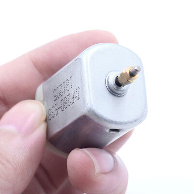

Thanks for the write up! I just replaced my rear hatch actuator, which worked about 30% of the time, and it's working great now! I did make a mistake with ordering my motor, and the new one did not have the brass key that I needed. I was able to pull the one off the old motor by using a pair of wire cutters to hold it while I tapped on them with a hammer. Then I soldered it onto the shaft on the new motor. Just FYI in case someone runs into the same problem. It only added about ten minutes, including finding the key in the large flower pot in which it landed when it popped off. 🙄

I only replaced the rear hatch motor so far, since the PO did the four doors. For the hatch at least, I needed the motor with the little brass key on the shaft, like the one shown here. It's five bucks in this listing, but that's about all the time I'm gonna spend right now searching "Toyota door lock actuator motor" on eBay for you. YMMV.
Thanks @Eyedaho! I had found a similar listing in my search which I will use is I don't hear back about a $2 option.
