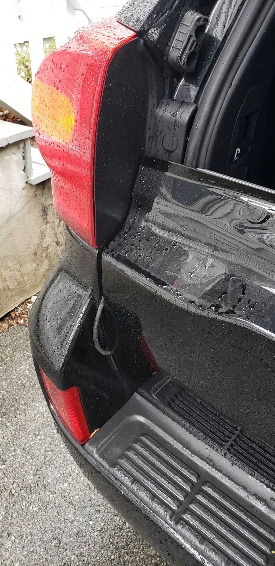

About 50% of the time, the cable that supports the lower rear gate gets closed into the gate. See pic. A little annoying - is there an easy fix, or does nobody else have this minor issue?
1957670

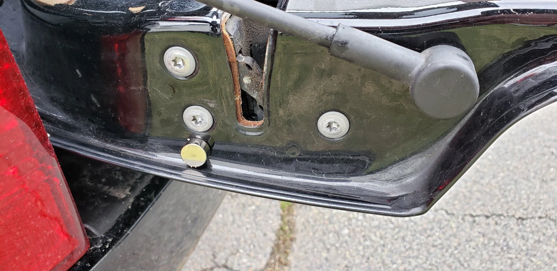

See the thread I posted a few years ago.
Very simple fix...
Markuson
Very simple fix...
Markuson
Amazing, thanks!
Did I see a mod for this same issue where you unhook one end of the cable and twist it before reinstalling?
It works, and the quarter size magnets work better than the dime size.
I'm so glad I saw this! I've had this problem since I bought mine. Just figured since it's an 08 with high miles they replaced the cable with wrong length or something and didn't bother looking for a solution...
Ordered some magnets off Amazon to fix this. This forum has everything
