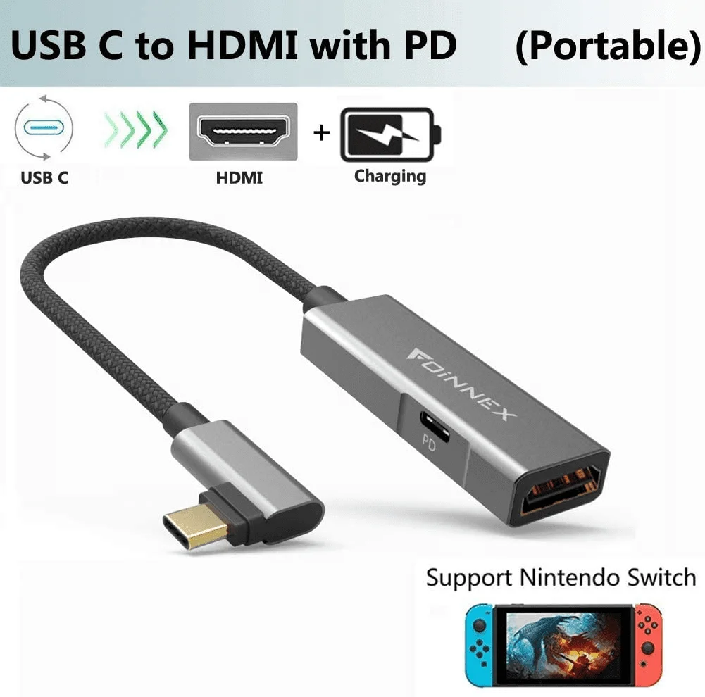

There are so many different threads about trying to find the right HDMI cables that work for 2016+ LC200 rear screens, but this thread came up the most when searching for "HDMI", so I'll post my solution here.
It seems like Apple users have no problem with the Apple lightning-to-HDMI cables, but I haven't seen very many successes here with regard to Android (USB-C to HDMI), or at least with Samsung devices. When I tried a few regular USB-C to HDMI cables, they would sort of work, but the video and sound would momentarily blank out every 5 seconds or so before popping back. Really not watchable that way.
But this device works solidly for me (with Samsung Galaxy S9):
Amazon product ASIN B07X8F34KSFOINNEX USB C HDMI Charging Adapter
It also has the option to plug in a USB-C cable into the side of it to charge your phone while you're also sending video to the back screens. It just mirrors your screen to the back, so you have to leave your phone screen on, but I confirmed that charging via the LC200 USB port at the front was able to keep up. I paired it with just a regular HDMI to HDMI cable.

In my dealings with Samsung and hdmi out adapters- they generally need the power cable plugged in as well to work.
That's what I was assuming at first, but the device I mention above actually still works even when the power cable is not used. Now I am assuming that the Samsung devices perhaps are just picky, and having the power circuitry in the adapter (even if not used) is what makes the Samsung happy. 🤷‍♂️
