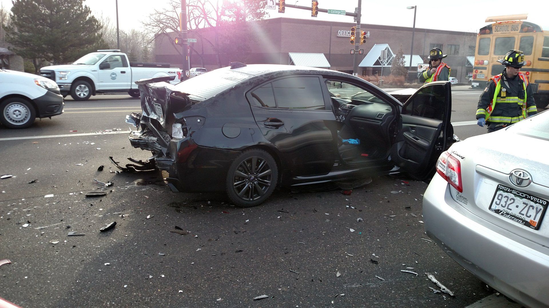

I was rear ended a while back on a Monday morning by a guy going 55-60mph while texting (the silver Camry). Me and the WRX (he was behind me) were dead stopped at a red light.

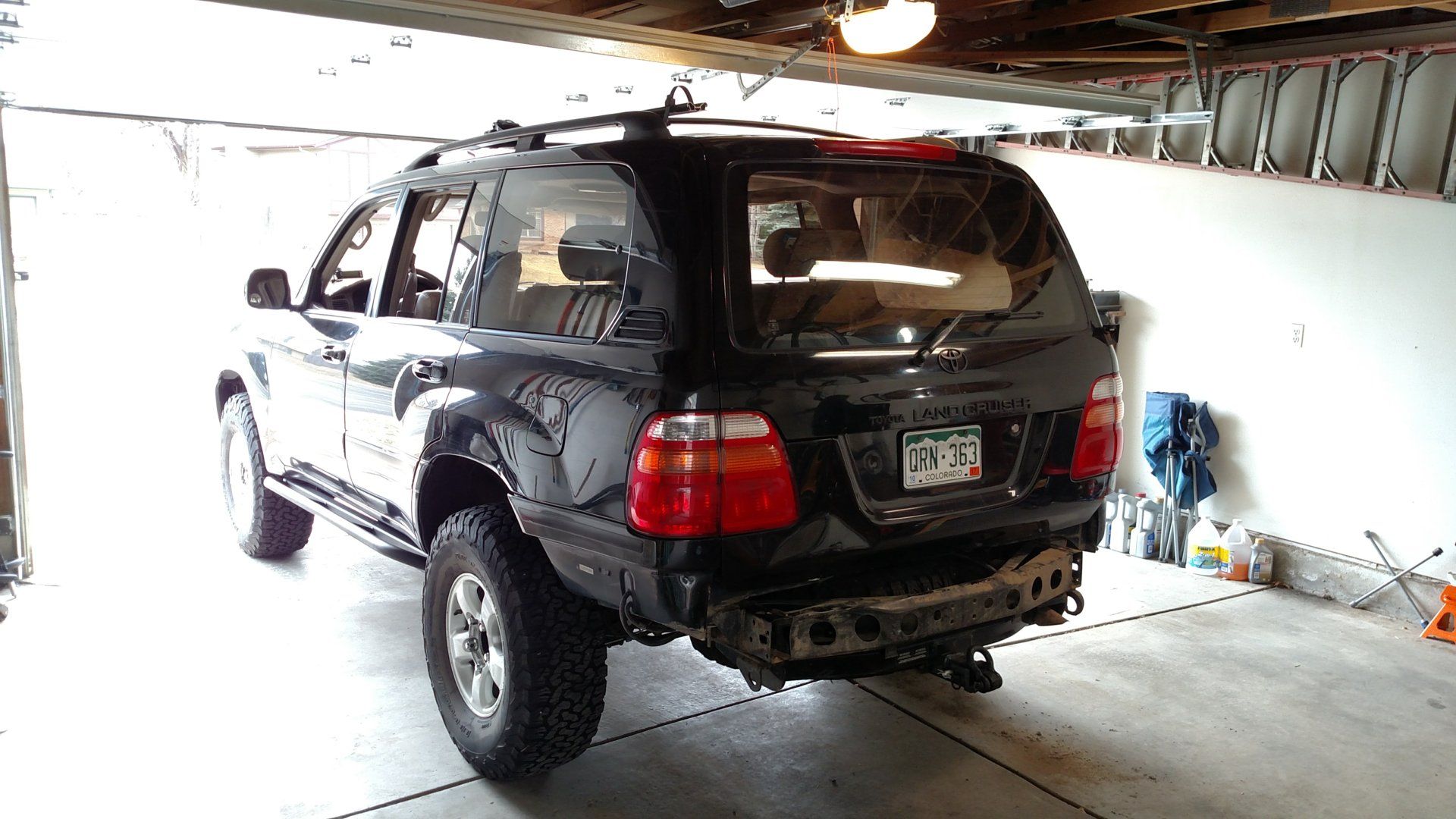

You can sort of see here the rear cross member is pushed in on the driver's side.

That bump above the exhaust pipe is normal as best as I can tell from my photos. The body mount you're talking about is just a sandwich mount to support the load there, it is supposed be slightly pre-loaded (in compression) all the time. I guess it is possible the frame behind the axle is tweaked up a little causing the sandwich mount to uncompress. I'm 100% sure the bent Panhard is causing the suspension to bind.
You guys are awesome, Thanks for the reply whitenoise..... this thread is helping me push forward and get her fixed. I am hoping we can continue to repair as planned with replacing this panhard bar to cure up the crunchy stiff noise I am getting when the rear end dips.

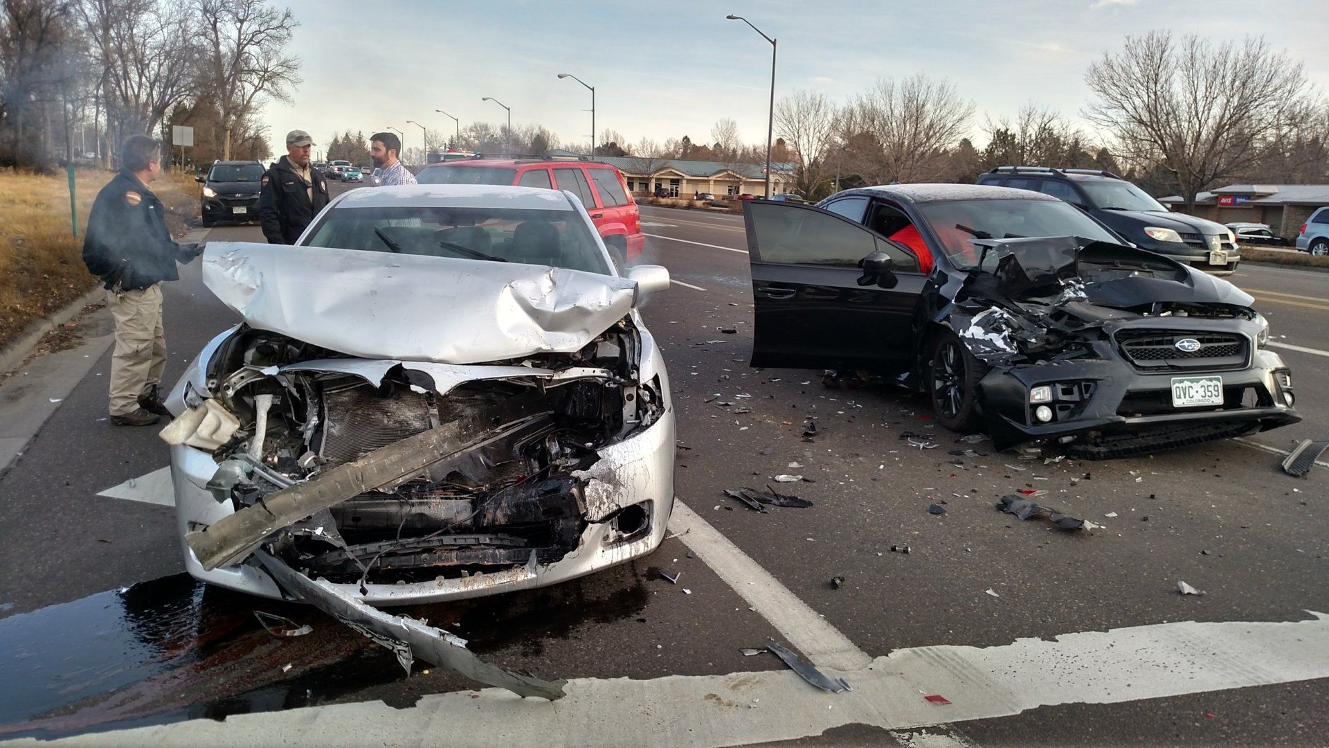

You can see how far she pushed me over the stop line in these shots, didn't even see it coming.

That doesn’t seem like a 70 MPH collision. Glad all are ok.
Maybe more like 50? IDK but it sure felt like 70.
Either way hoping to get the cruiser back to 100% . Turns out that panhard bar is contacting my rear diff and that is the crunching noise I am hearing. Have to limp it around until she gets fixed up
