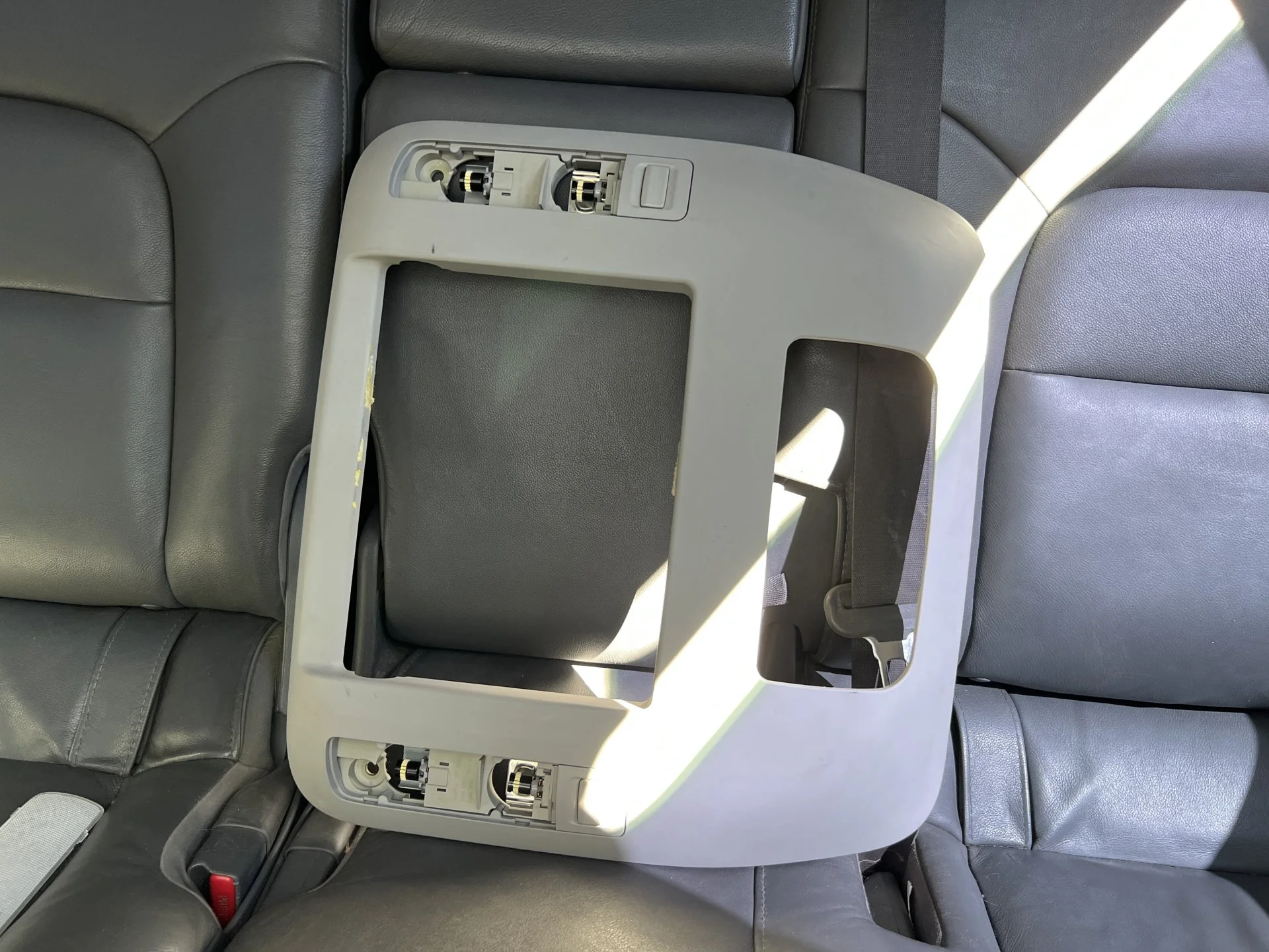

if any one removed their roof mounted video screen, let me know if I can take it from you, I want to experiement with how to effectively do a rear delete on the side before I remove mine. Or repurpose this to do a larger screen where I can do HDMI input.
