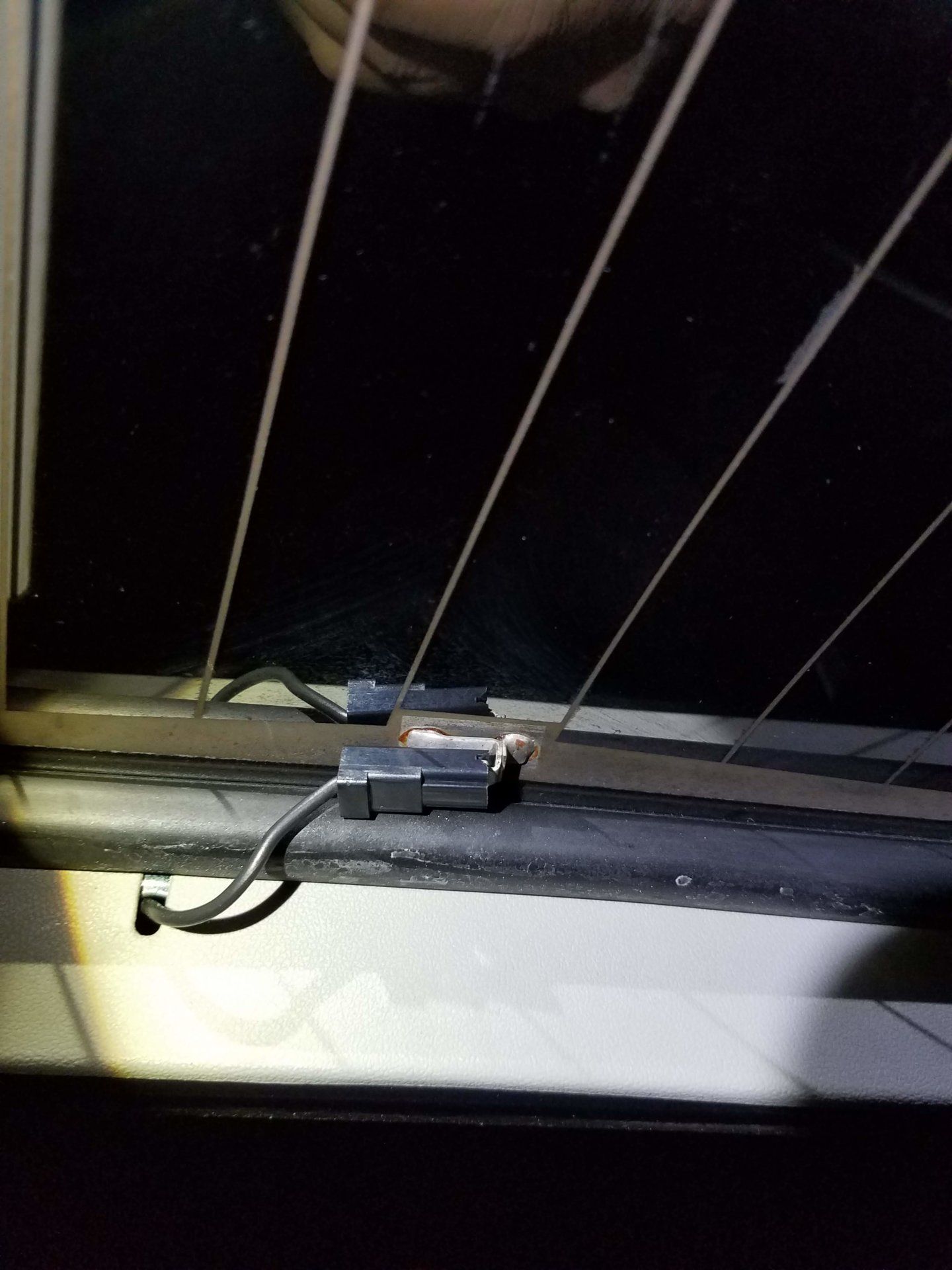

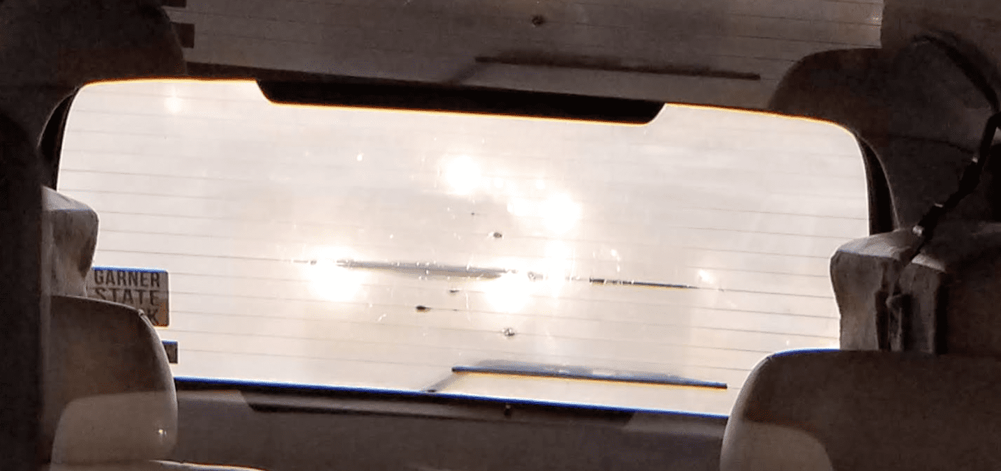

I searched but the threads I found were about the rear defogger not working at all. It appears mine is working - just not very well. Tried to use it for the first time I can recall today in rainy cold weather. It's performance was less than stellar. I had one grid line that appeared to work "ok" and a couple little circles (which after reading up on how these work I don't even know how that happens - I think there is either voltage through the grid line or not, not just in one spot in the middle of the window). After I got home I did some reading, reviewed the testing procedure in the FSM, and had a close look at the grid while trying to test (testing was somewhat unsuccessful but could be a function of my skill, darkness, cold or the old/cheap meter). I'm going to pick up one of those test light things to check it all again - that looks way easier. After having a close look, it appears that the vertical bars of the grid are really thin/worn out. I'm starting to think I need to "paint" the entire grid (verticals and horizontals) with the Dupont 4817 or sub. Tried searching the internet for a source for the Dupont 4817 and couldn't find it. Couldn't really find any one product that stood out with lots of good reviews, etc.. There is a permatex kit that includes epoxy and a tiny bottle of the paste but I hope to just tape off around the grid and re-"paint" all the lines so probably need more than comes in that little spot fix kit. Anyone have a success story doing this and/or a recommendation for the paste? Pics below of the performance and then the driver side and passenger side connections (can see how thin the paste/coating is there).

You will hate yourself trying to remove that paint and tint, did you know a rear window is $1000, at the dealership I am going to go paint first
hummmm, may need to re-think that plan.
I think I'll try to repaint the whole grid first (if I can find a product to do it with) but if that doesn't work I found a YouTube video on installing the Clear View defroster grid and that looks pretty simple.
However, I guess I'm missing something on the "scrape it off" plan. Seems that would be pretty simple with a flat razor. No? Is tint removal somehow involved with this?
I would assume the tint, even factor, is a film on the inside of the glass. If you take a razorblade to the defogger you will damage the tint. I guess some factor tint is embedded in the layers of glass but not sure on the LC.
