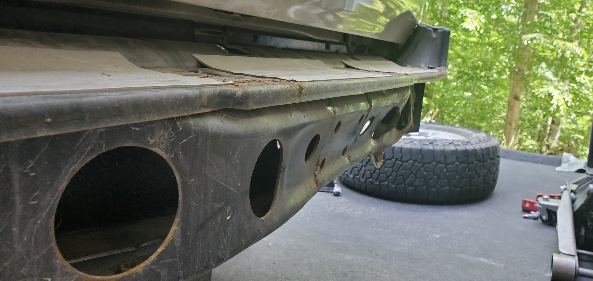

Pictures would help. There might be an alternative to replacing it.
not sure how easy it is to see but passenger side is pushed in and twisted under.

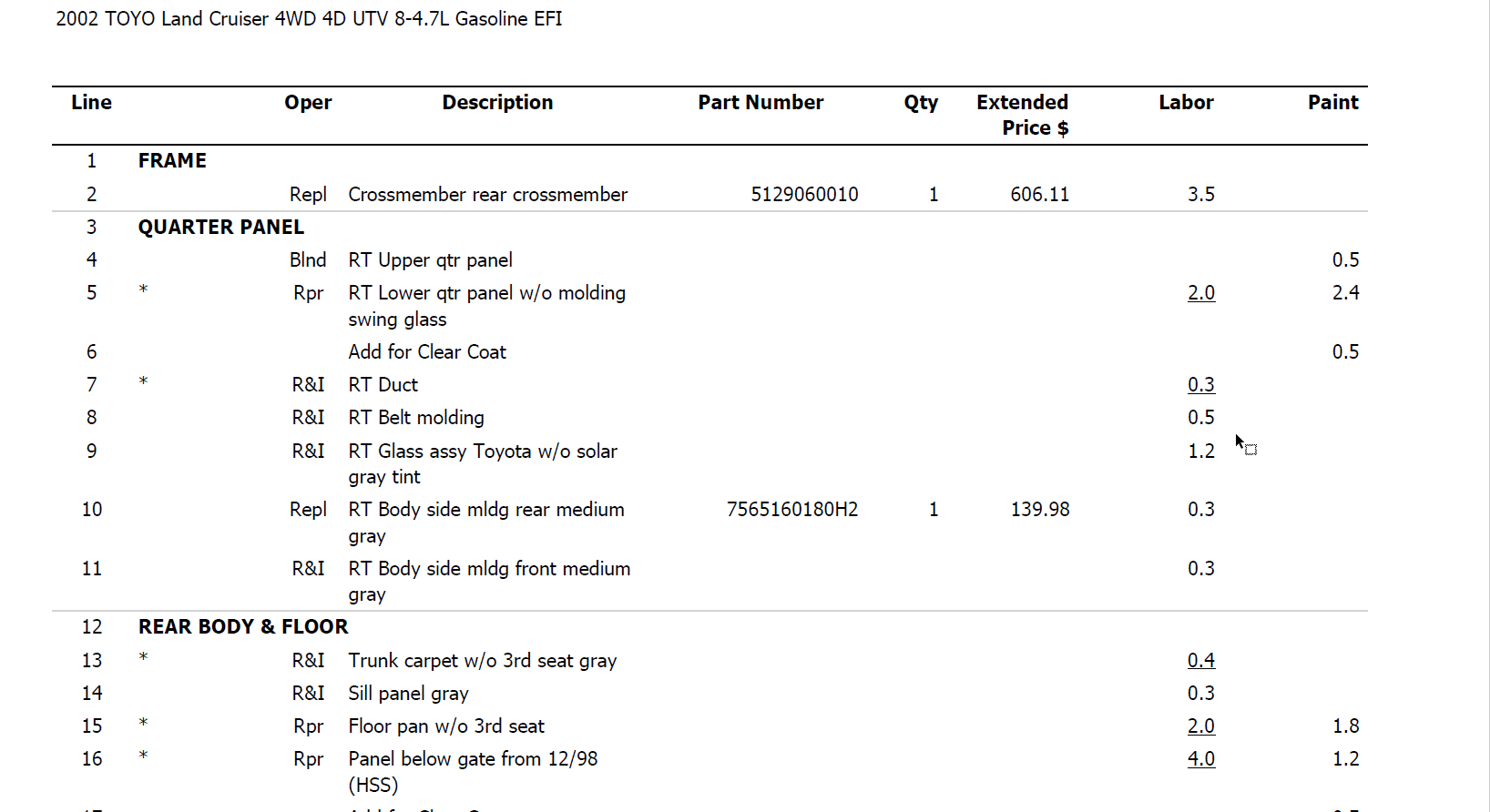

Insurance paid this tab, few hours labor + over $600 for the part. Line item #1
PS - I love how much money the shop got for all the " Remove and inspect " jobs. Did they really need to charge .4 hours to inspect my rear carpet? Insurance companies and body shops are such scheming little jerks.
