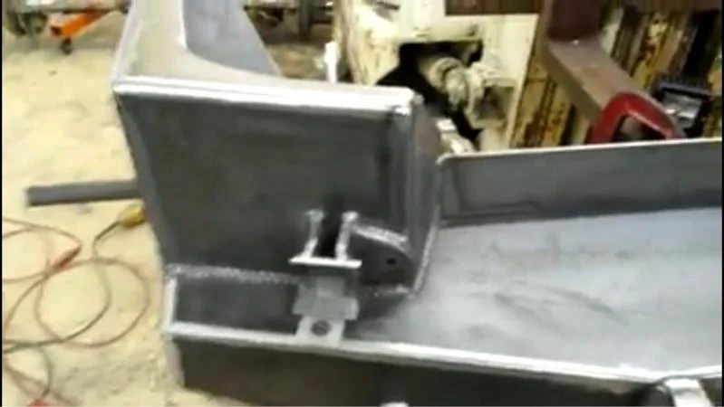

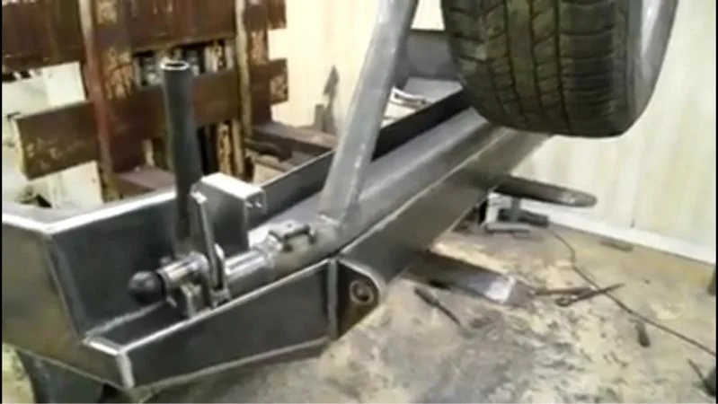

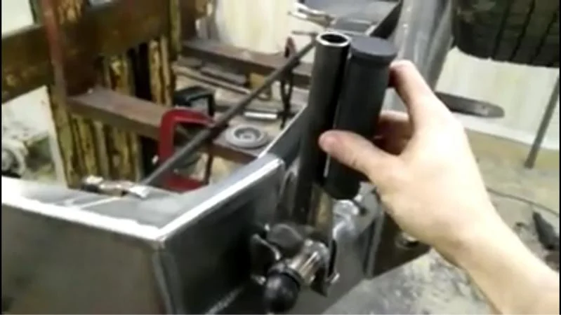

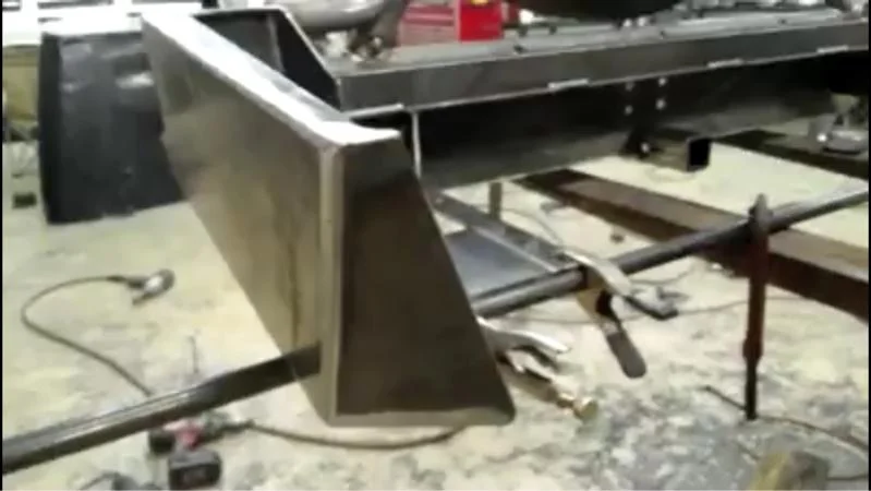

Couple teaser pics before powder coat

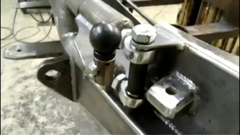

Do you have any concerns about the durability of the swingout when carrying a 35" tire over washboard terrain? I would like to see some type of gusseting at the base of the carrier where it meets the bottom tube.
No I don't have any concerns. I am using 2" .120 tube. It is supported quite well and if you'll notice the top tube is bent and then fishmouthed to give extra surface area for the weld and lateral load. The pivot is comprised of two chromoly 3/4 x 3/4 heims, each with a load rating of over 34,000 lbs. They are double sheer mouned into the bumper at the vertical frame tie in plate using a 3/4" bolt. The bumper is also welded inside and out to prevent cracking or tearing over the life of the bumper. Also I'll note that my latch is not a typical cam-lock. It actually works to add additional vertical stability. The arm when locked can not rotate at all in the latch. I am completely confident in my design. Our changes have to do with lift gate clearance.
I like the design of the swing, good application of round tubing. I was wondering about the heim design for the pivot but at 3/4" inch I think it is plenty stout, it also provides a nice adjustability feature to keep things tight, especially if one should have an 'event' while off-road. I can definitely see there is a ton of labor in both the pivot and the latch fab. The latch is a nice design as you mention it has a vertical support component (as opposed to simply holding the thing closed).
Have you run this general design in the past and is it rattle resistant?
Is there a hold open feature for the swing out?

The heim pivot I have used. This latch design is new to me. But I have played with it some. There isn't any way for it to rattle. There is both a nylon strike pad and rubber stopper that assure that.
Yes there is both a spring loaded lock-out to hold the gate open and to lock the latch closed so it cannot unlatch accidentally. It is designed to catch the arm as it's open to prevent to arm from swinging to far and either denting the truck or vehicles/constructions need by.
