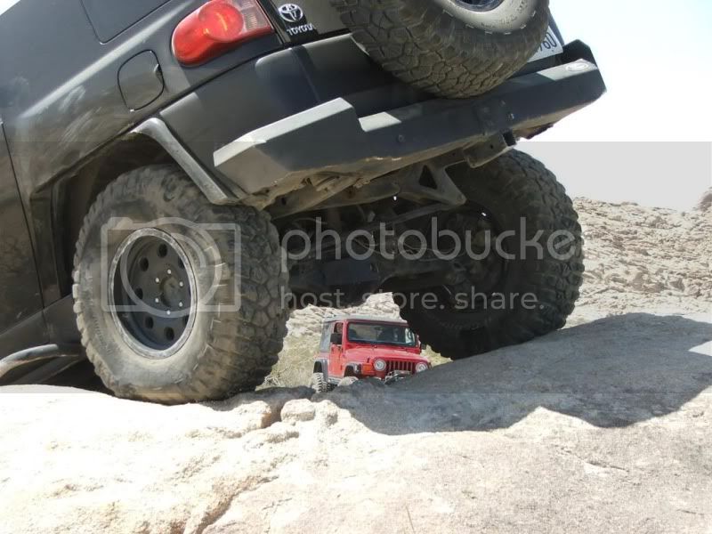

Metal Techs rear bumper has a 2X2 hitch receiver incorporated. It is Hella stout and has protected my rig many times.
This isn't my rig but shows off the bumper very well. I couldn't find one of mine that showed it off as well. Metal Tech is the way to go if you want a tube style bumper.
