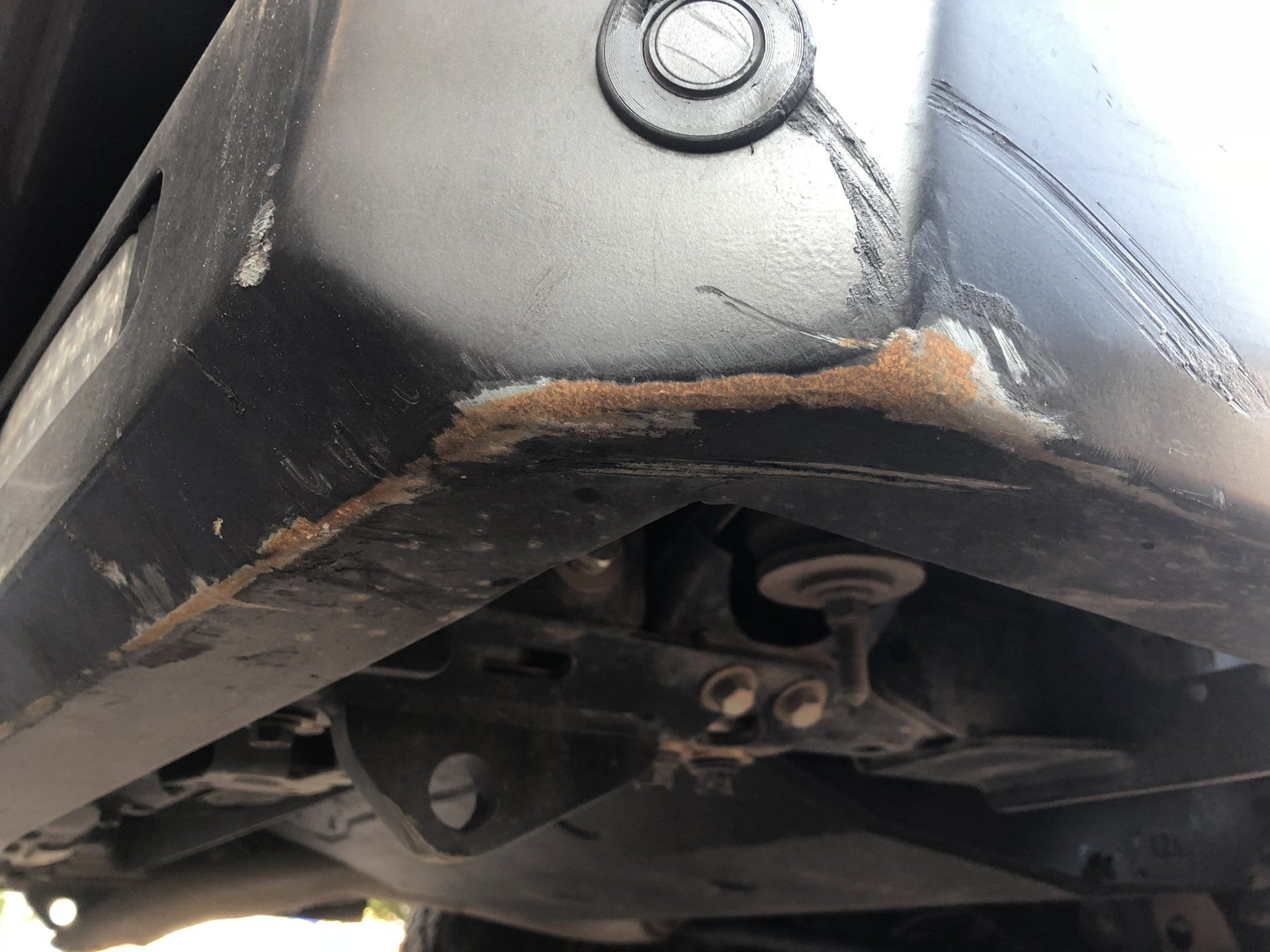

A curious thought occurred to me while installing an LRA sub-tank recently...
One of the most constraining factors off-roading is the departure angle of the 200-series. With it's long rear overhang past the rear tires.
Could an effective rear bumper slider be made for the 200-series platform? Something low profile and lightweight that could protect the rear tupperwear. While still looking good and not detract from the overall look. Hardcore rock crawlers would still want to go full rear bumper. But perhaps for the average enthusiast?
Perhaps it's an ugly and terrible idea. Just tossing this out there. @benc , @TRAIL TAILOR
There's not a lot of examples out there, but an idea.

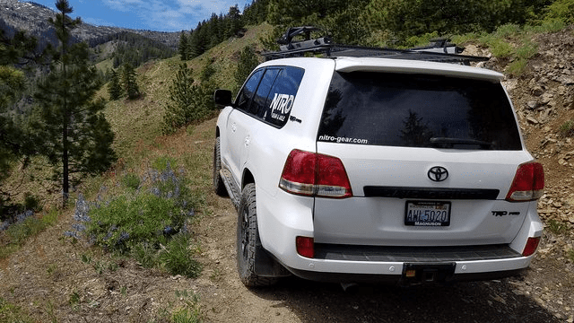

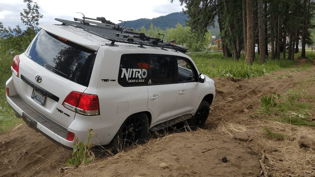

Came across @Nitro-gear 's latest beast of a 200-series photo's.
Not sure what's he's done to the rear bumper, or if it's only paint? Tried to find more pics but this is all I could find. Either way, I think it gives an idea of the concept. A minimalist rear bumper or slider, could look great setup like this. Ties in really well with the side sliders and tow hitch.
I think there's ample opportunity here for a product like this that adds rear tupperwear protection without the full gonzo commitment or weight of a full on rear bumper?
Paint, vinyl, or plastidip. Probably vinyl, which appears to be on the hatch.
