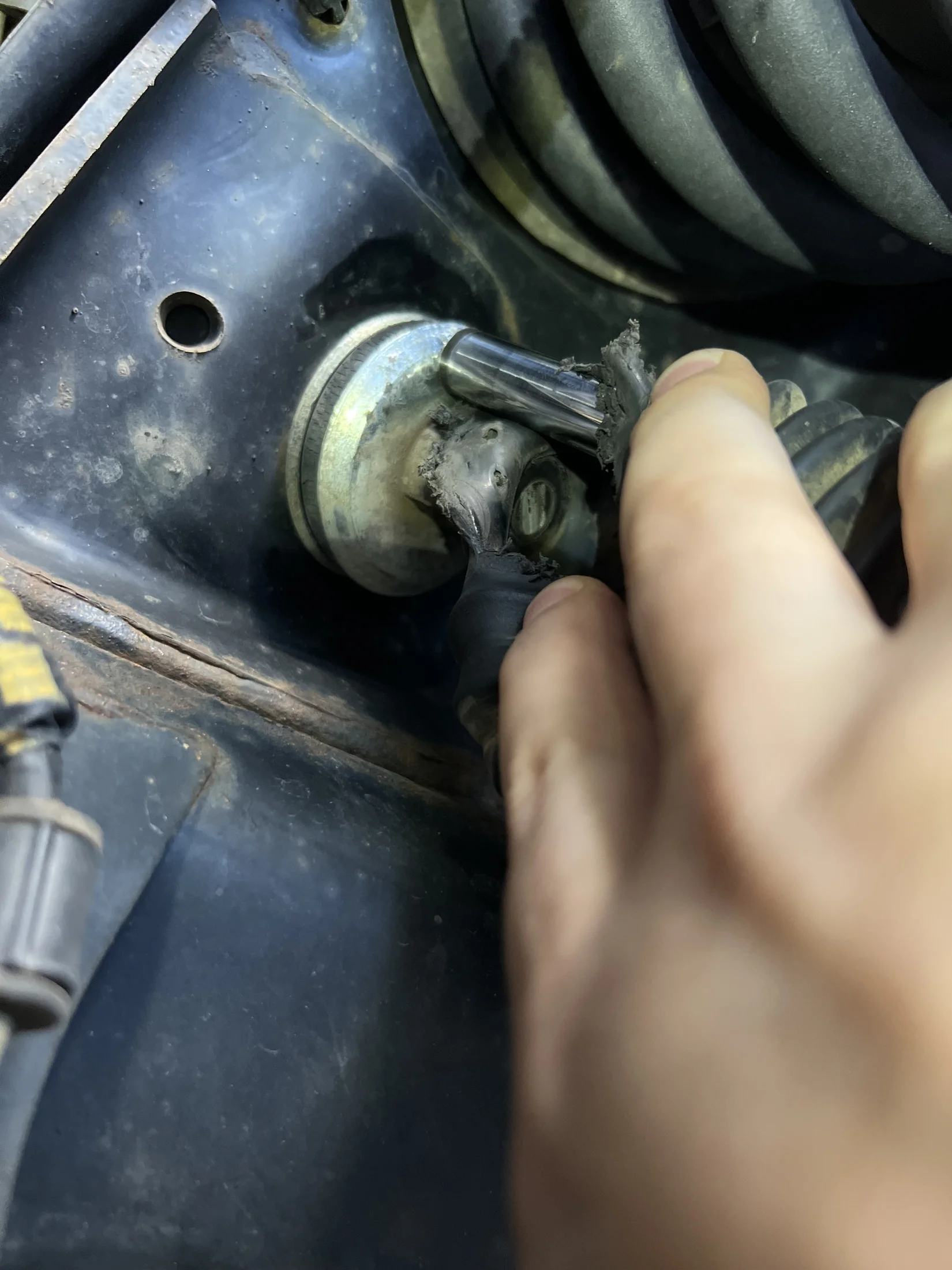

The top mount on my 3rd gen 4runners rear bilstein shock snapped. When I called them, they said it is not designed for the 3rd gen so end of it. I then bought another Bilstein (yeah!) and kept the top mount bit flexible, so far so good.
Chalk another one up. Heard some rattling/clanging and thought it was just my sway bar links until I got under and looked.
5160s that I’ve only had installed for about 2 years I think
Page 1. TL;DR Its over tightened like fk.
The 100 washers and rubbers are extremely big diameter, so the leverage over the shaft is ALOT if you over tighten them, and there is no flex left for the shock to swing around when the diff moves around on the panhard rod.
The correct method is to do up the lock nut 2-3 more flats after you cant turn the rubbers or washers with your fingers any more.
To stop them coming unscrewed [also caused by side loading from over tightening] we tack weld every set we install to prevent them coming unscrewed, but can be ground off if ever need to be disassembled.
The Bilstein shaft is small dia, this means more oil, and less displacement when compressed, and is why they are designed this way.
