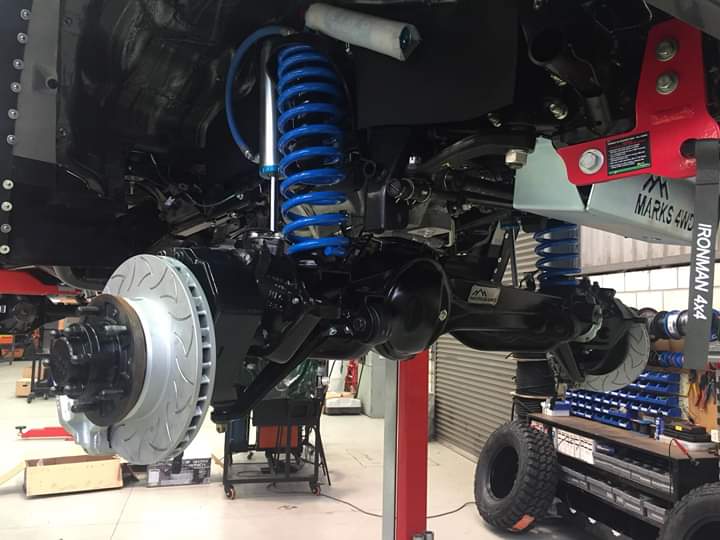

I've seen the JMACX coil conversion / width correction swap on some friends VDJ79. It's a very tidy kit & is working really well.
Although personally I'd forgo the simplicity of the bolt in kit & fab something up with longer control arms for a better suspension action.
Cheers
Clint

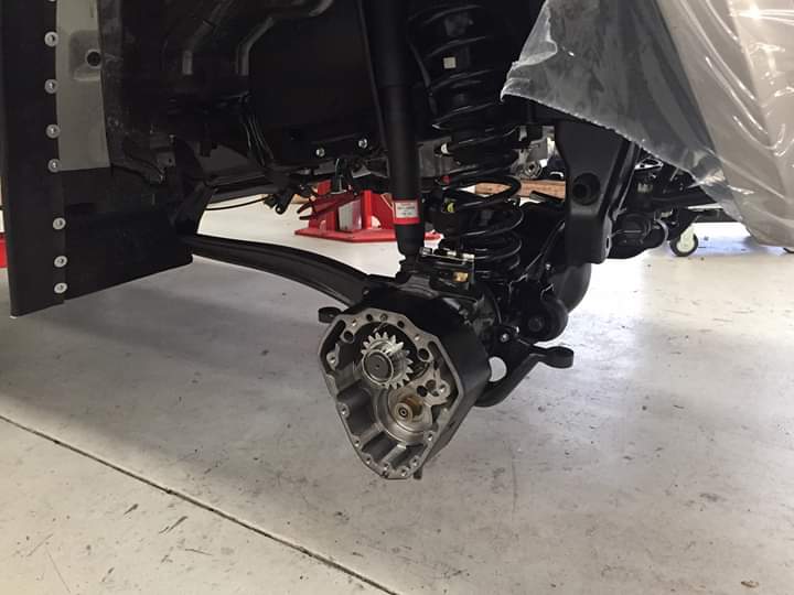

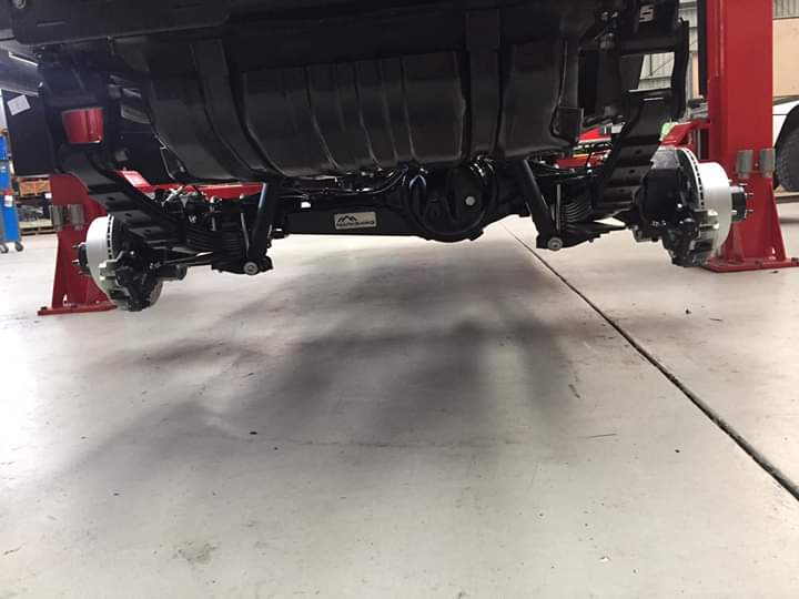

SUPERIOR ENGINEERING weld in kit. Triangulated 4 link.
Long arm option
They are also in the final stages of a bolt in kit
And the Dana 60 option
Design inclusions:
Retains the full-float design; vehicle weight is carried by housing for greater load-carrying ability
Original axle centre offset with 95mm wider overall track – no wheel spacers required
30 spline larger diameter forged 1541 steel alloy axle shafts
Selectable electronic locking differential – genuine Harrop Eaton E-Locker™
Heavy duty 9¾” (248 mm) ring gear
Massive 3½” (89.9mm) outside diameter 0.390″ (10mm) wall thickness axle tubes
Heavy-duty suspension brackets – ready for your heavy-duty suspension upgrade
Nodular iron diff cover
Spicer® 1350 Strap-style/Half-round end yoke
Heavy duty Spicer™ drive shaft
Designed to re-use the original vehicles brakes, ABS, wheel hubs and wheels
