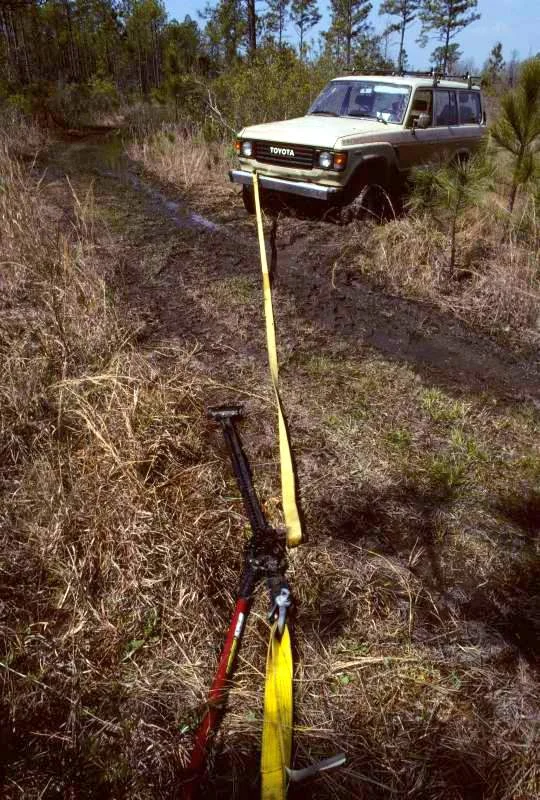

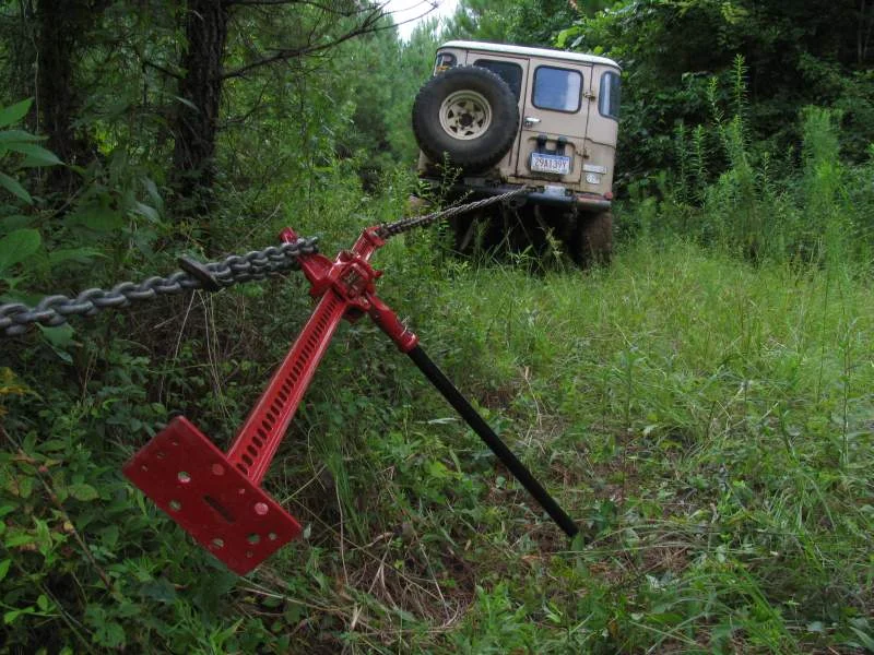

I've used the Hi-Lift in a winch mode or as a come-along more than a few times, probably more in this fashion than in a lifting-to-get-unstuck method. You need a chain or strap to attach the jack to the anchor then a second chain hooked between the jack and Cruiser. Having at least one chain which is adjustable may be mandatory because you'll need to shorten it as the vehicle is moved. I have a couple of pics to illustrate and in looking at them I see that having a chain is not mandatory :doh: but it sure will make the extraction go a little quicker. Straps can be doubled up to reduce their length.

In the pic of the HL above, it would not be a bad idea to tie the rail (foot side) to the chain or strap so that there is less chance the chain would slip off the tongue...

I'd also consider the method of winching shown to be dangerous. Haveing a loop hooked over the foot of the jack is far less than ideal, instead a rater D shackle should be used to attach the strap/chain to the foot using the intended hole.
I prefer winching using chain on the vehicle side, so that if the pull distance of the highlift isn't enough to free the vehicle the chain can be shackled off, the foot returned to the other end of the jack, and the weigh taken back up. This really isnt something you should do without being shown first
