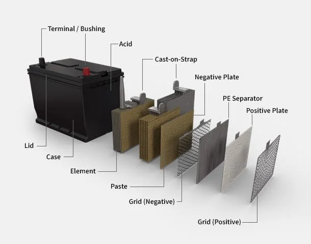

If it's new, and if it is full of electrolyte, the only way a cell would be "bad" is if the connection was broken. The way these things are manufactured, that's hard to imagine.
