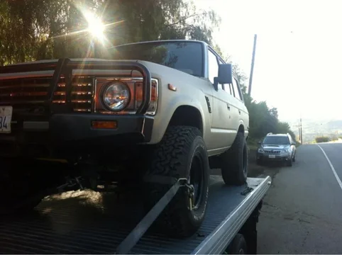

I'm going to call Richard at K&H in the morning and see if I can get it down there before I need to be at the office.

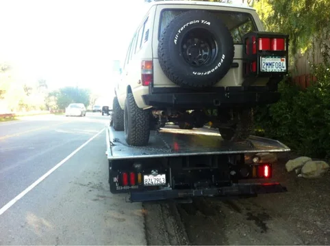

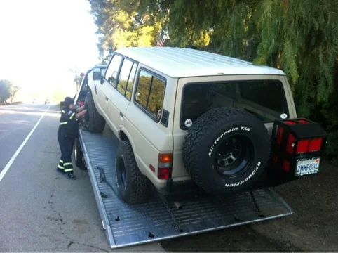

Loaded it up on the truck this morning and sent it off to K&H. Hoping to hear back with some results in the next couple days.
On another note, is it just me or does a 60 even look cool on a flatbed??
Oh, and AAA took 2 freakin hours this morning!!
