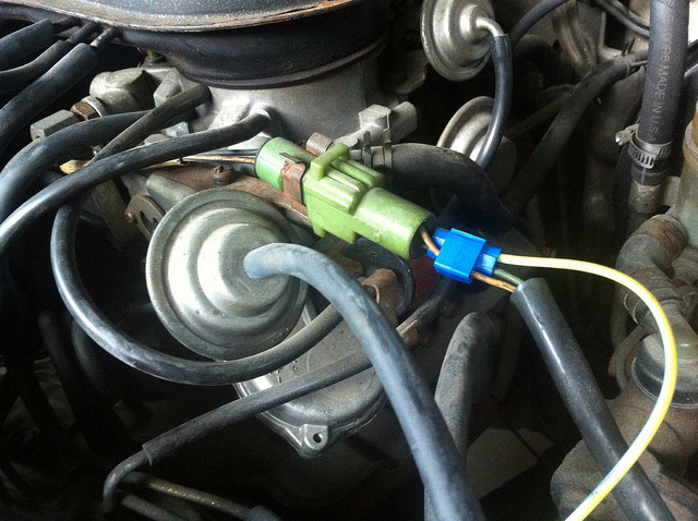

Also, you can see in the below picture that a modification to the ICS has already been done. This was done by "a reputable landcruiser shop in the SFV" off of Canoga. So, I am very confused as to how/why one would make these modifications. There is apparently a "white wire mod" as well as a "green wire mod" and I am not sure which is which at this point.

Can't really tell if that tap is on the white or green wire. Should be a tap to the white wire then directly to ground. Green wire is 12v so it may be a power tap for something else, if it's to the green wire... Richard did this ?
Sounds like you've got an exhaust leak, too, if you didn't already know...
Yup Richard. Yup exhaust leak. And yup, the tap is on the green and goes to ground. It is, however, on the opposite side of the connector from where you did your white wire to ground. Not that that would make a difference, 12v is 12v.
I'm thinking I may just have this thing sent to him on Monday. I'm kinda at a loss.
To bypass the Emissions computer for the ICS the WHITE wire needs to be grounded. Not the green. The "computer" controls the ICS thru ground.
Richard obviously knows what he's doing, but indeed if it's green wire to ground, that is not correct. That is just shorting the circuit. Think about it: 12v+ (green wire) straight to ground ?
Did that get hooked back up properly after all the work you did? That 12v tap may have been if you were not getting power to the ICS, then it might have gone to a Key On power source ?
Connector side, as surmised, doesn't matter.

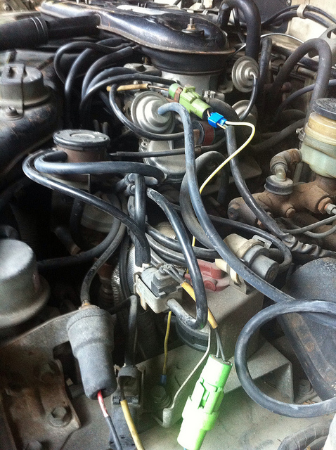

More Pics
I didn't alter anything in the engine compartment other than the choke cable and now, the temp sender wire. Everything else is as before paint and body. Thats the weird thing, was running great from Agoura to Topanga Canyon Blvd, then it just fell on its face. Something changed, or some part broke/wore out.

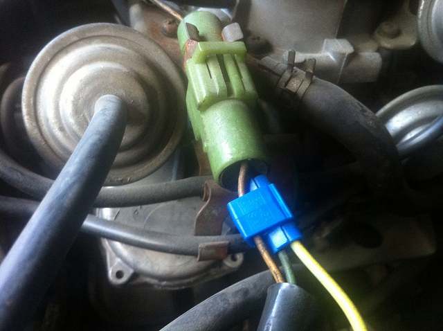

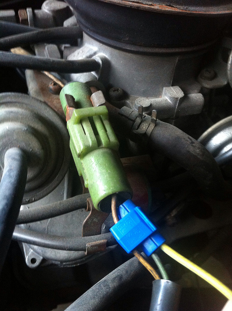

Here are a couple better pics of the mod that Richard made last time it was there...
In the first pic you can see that it is the green wire that has the tap on it, the "white" wire (mostly just grimy) just goes through the cage of the scotch tap;
Slightly different angle;
In this pic, you can see the yellow wire that was tapped into the green, going to ground. I clearly need to break out the volt meter and start checking things in here.
