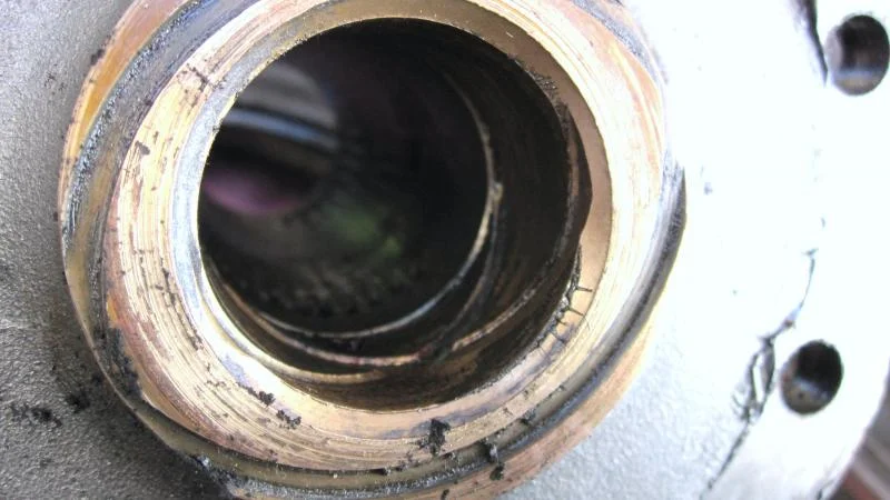

~500 miles in started hearing loud vibration sound from DS front, intermittent mainly on acceleration. Kept going since he was in the middle of nowhere in West Texas, made it with only the intermittent noise. Drove truck to ski area the next day, noise happened the whole (10 mile) drive back to town.
He called me, I immediately told him it was probably the spindle bushing. Only other possibilities I could think of where brake issue or wheel bearing issue (brand new).
He took it to local shop, spindle bushing grooves were caked with dried grease on one side, other side clean ... no scarring on outer edge of brass bushing. I told them to have them clean it out and re-assemble everything correctly (he gave them FSM section).
He's afriad this might not be the issue since there was no real scarring, and it might happen again in the middle of nowhere on the drive back. Wants to pull front DS, lock CDL, and drive home in 2WD.

Here's the pic he sent me of the spindle bushing (crappy camera phone) -

Make sure they pack the bushing with fresh grease before they reinstall it! Good luck!

That bushing needs a metric crap-ton of grease in there. A dry spindle bushing is by far the most common problem after a front axle service.
HUGE thanks to Tucker for being persistent and convincing me to have the shop clean up that little smudge of dry grease. Just drove the truck back to the cabin with no issues / no sounds. We're here til Saturday so I'll have a chance to put some miles on it around town before I have to make the trek back. The guys at the shop could not believe a little cleaning and some new grease was all it took.

Yeah, and this was the second time that had torn it down and put it back together. The first time they noise was still there... the 2nd time I just asked them to get it as clean as possible and repack with fresh grease. That's all it needed apparently.
